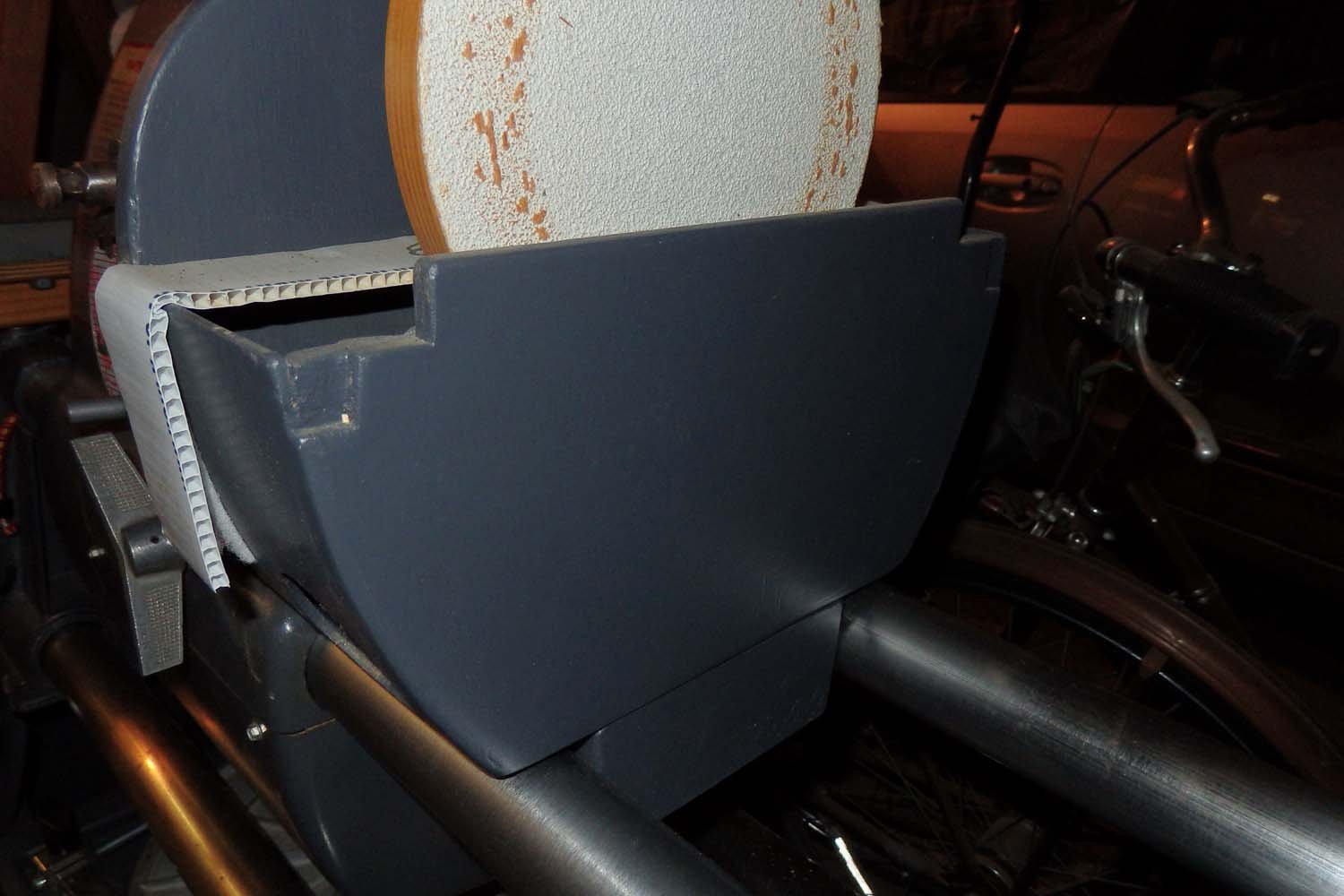

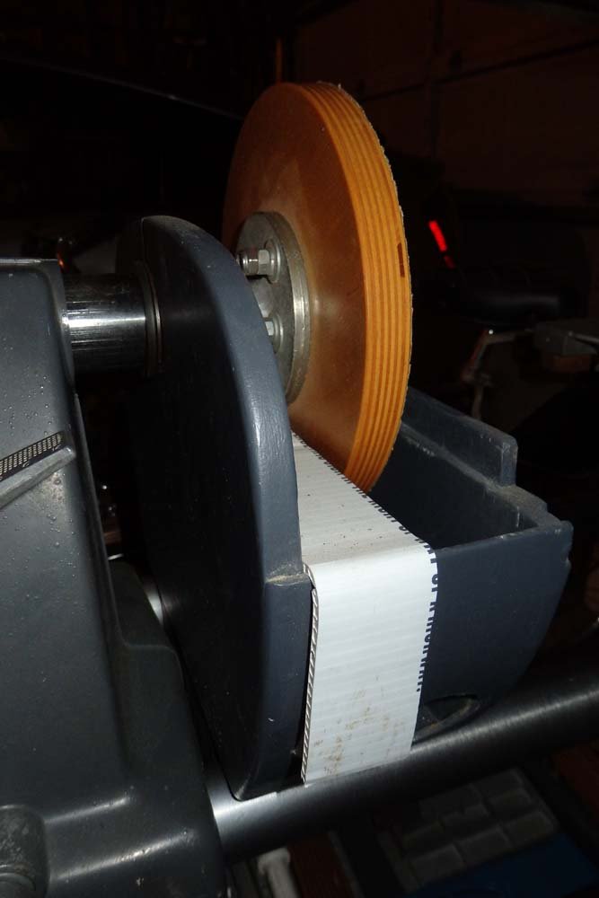

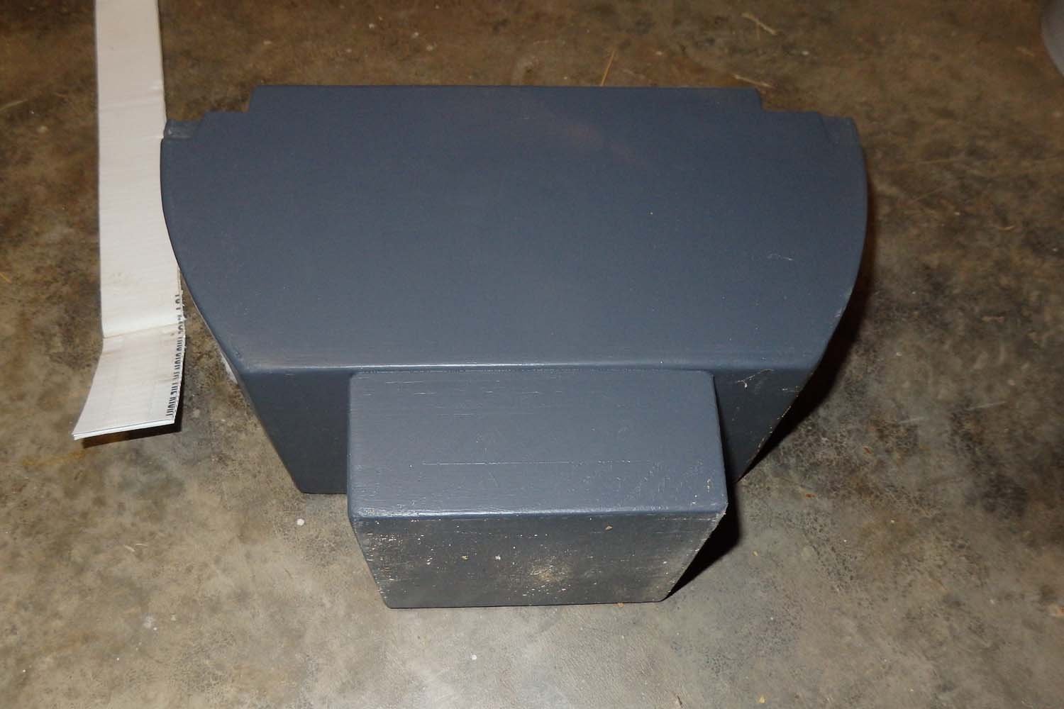

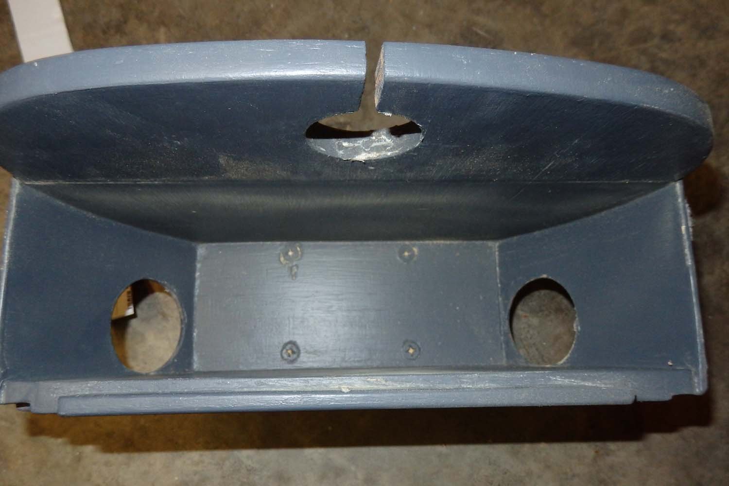

I made a chute for use with my Mark V (500). Modeled after my lower saw guard, but larger. Made mostly out of 1/2" plywood and 1/8" masonite. A block on the underside fits between the way tubes to keep it from rotating. Two holes for 2.5" dust collection hoses. In addition to a steel and an aluminum 12" disk, I also use a 8" disc that I made out of 3/4" plywood and is permanently attached to a small lathe faceplate. I keep my coarsest grit (36) on the 8" disc. When I use it, a removable velcro-attached filler strip between the back of the disk and the left side of the chute helps close off the large gap for better suction. Can only get left edge of table close to sanding disks, not have disks come up through table. With two dust collection hoses inserted, it does a pretty good job of catching a lot of the dust.

I like this approach. I need something like this and the way you have it sit on the way tubes is quite clever.br549 wrote: Fri May 14, 2021 7:24 am I made a chute for use with my Mark V (500). Modeled after my lower saw guard, but larger. Made mostly out of 1/2" plywood and 1/8" masonite. A block on the underside fits between the way tubes to keep it from rotating. Two holes for 2.5" dust collection hoses. In addition to a steel and an aluminum 12" disk, I also use a 8" disc that I made out of 3/4" plywood and is permanently attached to a small lathe faceplate. I keep my coarsest grit (36) on the 8" disc. When I use it, a removable velcro-attached filler strip between the back of the disk and the left side of the chute helps close off the large gap for better suction. Can only get left edge of table close to sanding disks, not have disks come up through table. With two dust collection hoses inserted, it does a pretty good job of catching a lot of the dust.
