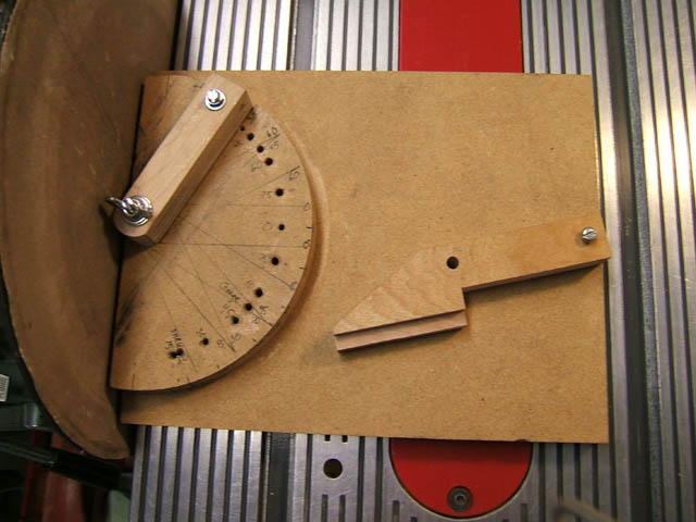

In an older PTWFE there was a jig for sharpening with the disk sander. It had a small wood base about 7" x 9" with a runner under it for the miter slot. There was a half circle on top of it with a 3/4 x 3/4 piece of wood mounted to the center of the circle that could be adjusted for the desired angle, see attached photo.
Hope this gives you some ideas.

- Sharpening Guide.jpg (80.65 KiB) Viewed 21547 times
SS Sharpening Guide
Jim
Does this run in the t-track? If it does, what do you use for t-nuts?
james.miller
- Posts: 303
- Joined: Thu Jul 20, 2006 2:16 pm
Sharpening Guide
It runs in the miter track but was designed for a 500 table so I didn't put T-nuts on it but could if I needed them.
I always used the sharpening guide loose in the miter slot and slid it back and forth occasionally to get fresh areas of the sanding disk. But not past the vertical center or the disk will lift up the chisel.
