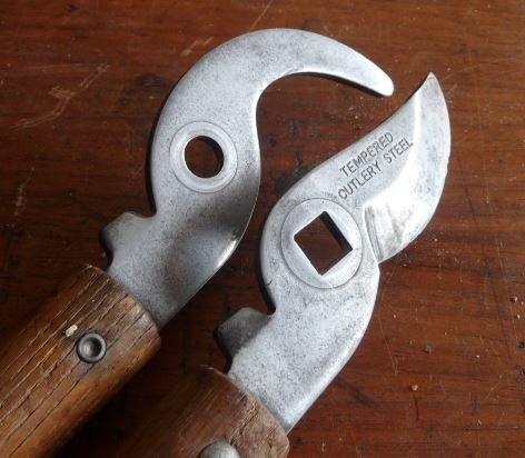

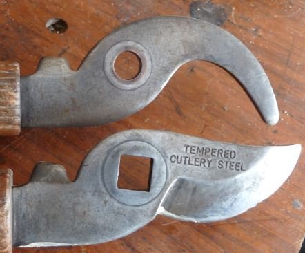

I put my 60 year old pruners on a patio chair and forgot about them. It rained overnight. When I saw them two days later the were already rusting. I've had a lot of tools for more than 50 years and none have rust. Using a wire wheel in the SS I buffed off as much as I could but they weren't where they had been so I used some Oxalic acid. It's Barkeepers Friend but cheaper. I've had it for several years and I keep some with a light oil base in a container. I rub it on with my finger which is better than using a cloth, the wipe it off. It's probably available from different sources.

It looks like you turned your "OH NO!" into a no problem. The pruners probably look better now than they have for some time with that cleanup.
