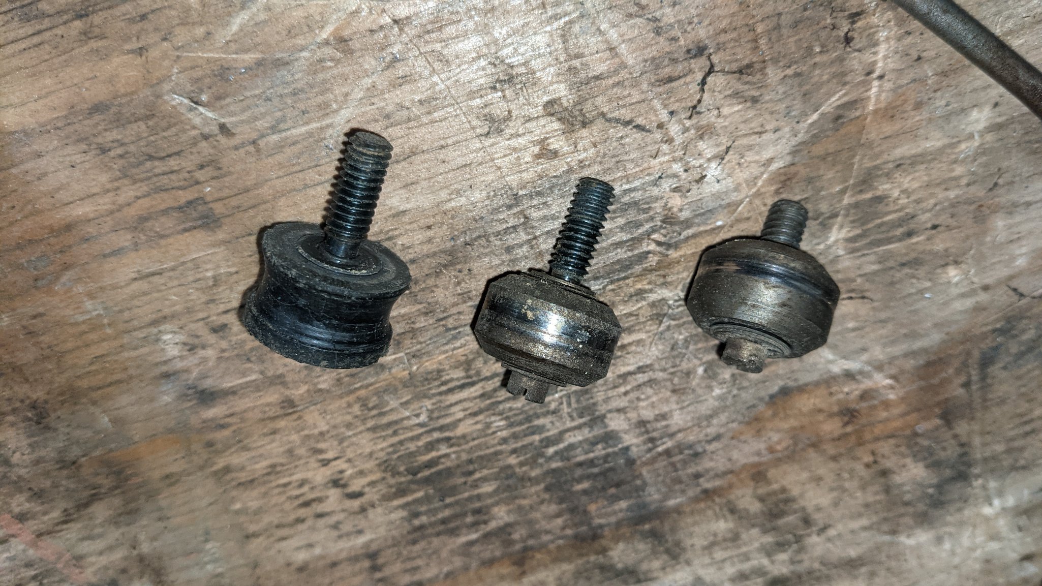

A couple questions:
1. since I have it 100% apart right now, should I replace the wheel bearings? Honestly both seem ok although the lower bearing, which I think is sealed, is a little clicky. Both spin great though. If replace, suggestions for which ones to buy and from who?
2. Behind the tensioner arm I have a plastic bearing the blade runs on, and it looks a little beat up. I've seen that other years these were metal bearings. Seems like something I should replace, any suggestions for which one to buy?
3. The upper and lower bearings behind the blade above and below the table also looking a little rough but are working and not squealing. Thoughts?
Thanks!
A couple questions:
Thanks!

Replace them with the current version.

1. If the lower wheel is turning smoothly don't worry about it. That is a sealed bearing and can be difficult to find and replace just it. Otherwise you have to buy a complete Lower Wheel Assembly. As for the upper wheel remember to grease the needle bearings inside the wheel while you have it off the Upper Wheel Arm and Axle.
2 & 3. I would definitely replace the Auto-Tracking Bearing. It is very worn down and likely has the blade tracking farther back on the wheels than desired. While at it go ahead and replace the Upper and Lower Rollers. The Back-up Roller Retro-fit Kit will give you the parts needed to do all three bearings.

Re: Bandsaw rebuild
Ok, I think I'll follow all that advice (stick with existing wheel bearings, grease them up, get the retro-fit kit).
