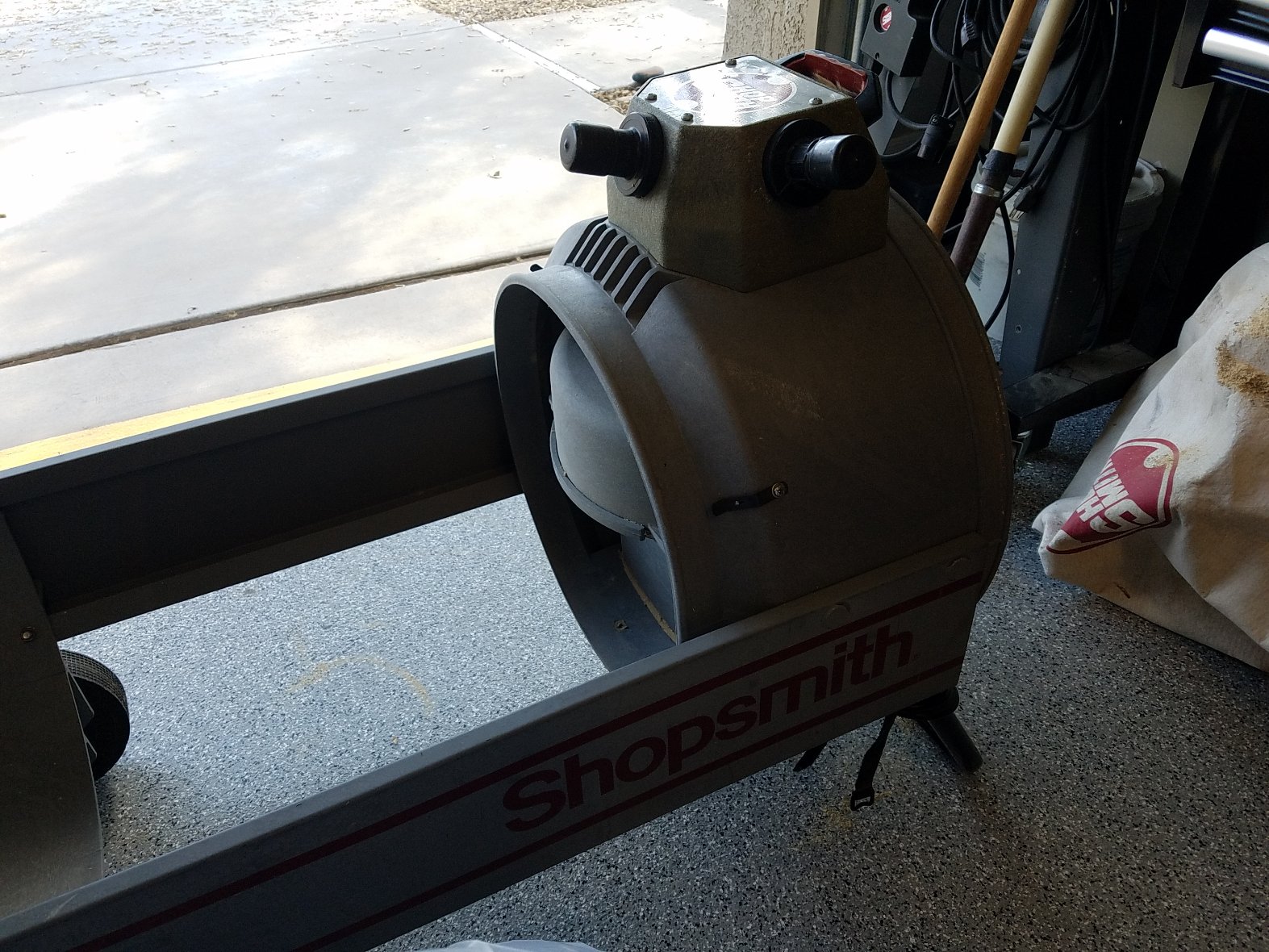

This has been a frustration for all of the years that I have owned the DC3300 Dust Collector.
Changing the collection bag gives me reason to cuss every time I do it.
The circumference of the dust collector (where the bag attaches) is approximately 50". The circumference of the replacement bags is 64". Can anyone tell me why AND what do you do with the excess. I've tried distributing and I tried folding it. Neither works well and both are a PITA big time.

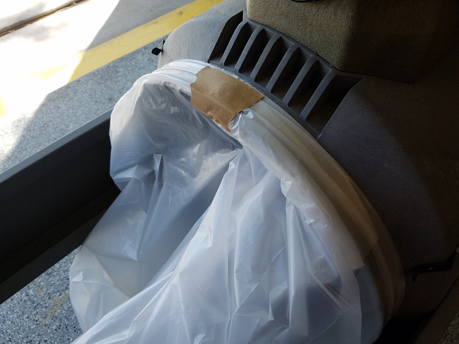

After years of putting up with this, I found a partial solution today. I put on a new bag in about 5 minutes without punching any unwanted holes.
I simply laid the dust collector down on its sides, wrapped the bag around the housing, folded over the excess and tapped it in place with packing tape and then installed the adjustable ring.
Could have a neater job dealing with the excess. Next time.
