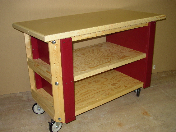

It will be a little while before I get to work on it. Right now I am doing my research and thinking through designs. I am pretty sure that I want to build an offset table so that I can ad and Incra system in the future. I also want a cabinet style with a dust collection box and lots of storage. I'll probably mount it on casters so I can move it around.
I have recently started a "shop remodel" to improve the looks and function of my basement workshop. I have completed a roll around work cart that is VERY handy. I am currently working on the "Ultimate SPT Storage System" (pictures in a few weeks).

tdubnik, the cart looks great, and very sturdy.
That reminds me that I need to make a cart for the garage and a printer cart for the office.
Somehow I'm falling more and more behind on projects.

tdubnik,
Now that is a real smart looking cart. Very nice job. If only I had a solid floor to work with. Can't wait to see what you come up with on the spt rack.
