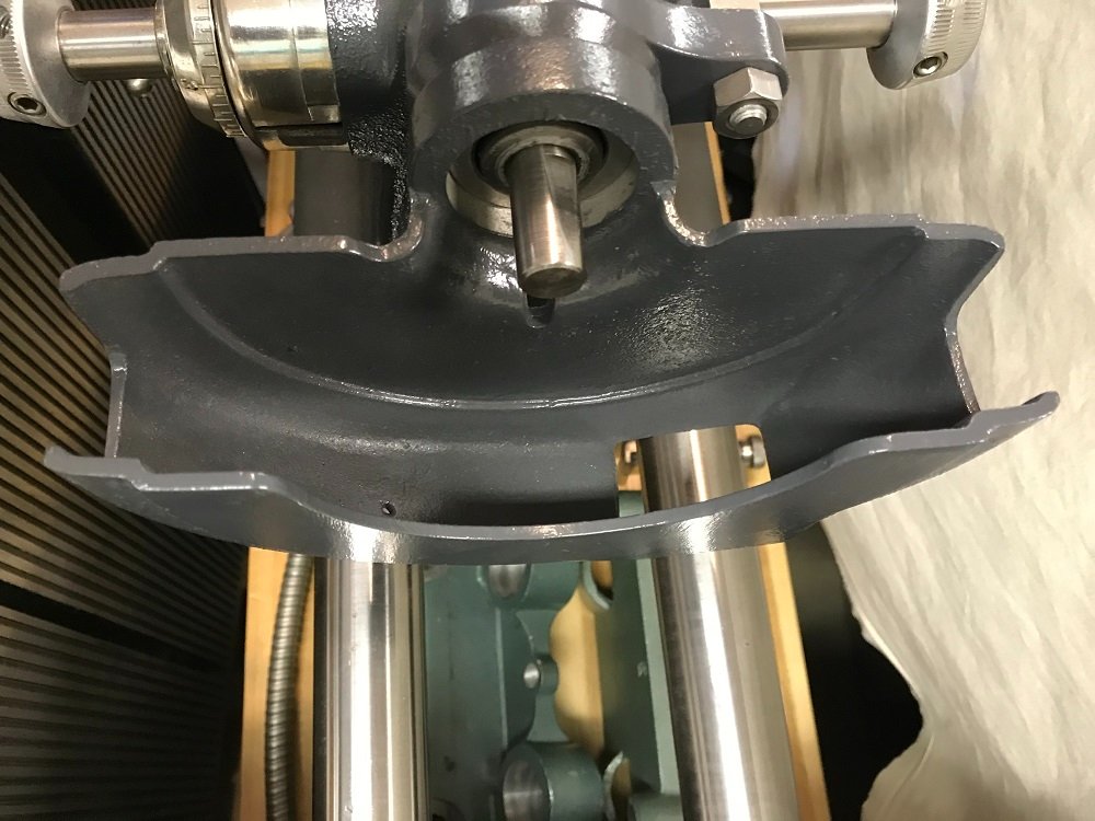

edma194 asked about the lower saw guard and you said "Yes, I have the saw guard." Do you mean the Upper Saw Blade Guard the attaches with a screw to the back of the table or do you really have a Lower Saw Guard as shown in the picture below?
_ _
As a lower saw blade guard it is not a very good one but isn't very common either. For a better Saw Guard combination for the Model 10's I use the upper and lower metal set made for the Mark 5 part numbers 505627 and 505628.

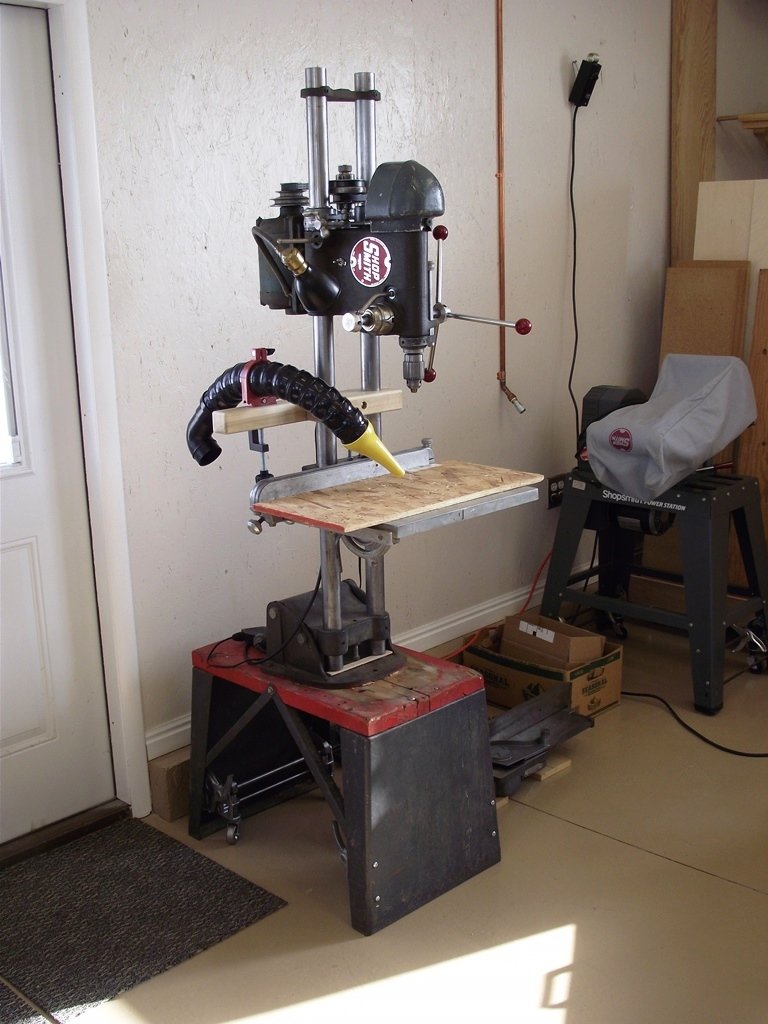

- DSCF0999.jpg (118.03 KiB) Viewed 1306 times
- Posts: 4534
Re: 10e owner, new to forum, what to do with the unit
John's is a great example of turning it into a dedicated Drill Press and more like I was referring to. It takes up less floor space. Note that his has the Speed Changer and a couple additions with the attached dust collection tube and a an original gooseneck lamp to light the workspace. If you want more storage you could make a storage stand for it instead of using the original shopsmith metal bench ends as John did.

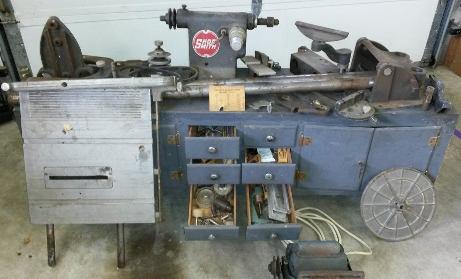

Just some other thoughts, If you do make a storage bench in the original 5 foot length not only would you have more storage space but you would still be able to use your 10E for the other functions if the need arises. A feature I like is Horizontal Boring which is a Drill Press laying down. It sometimes give better control on a project and size is not limited by the distance from the Drill Chuck to the table or floor. As I like to say "If you can support it you can drill it." The picture below is a Model 10ER I purchased to restore that came on a storage bench. It has lots of storage with the cabinets and drawers.
_ _
Sorry I didn't get a better picture of just it without the 10ER parts all over it.
_ _
