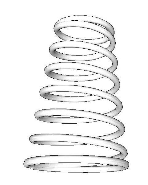

Case in point I just finished a spring. It is the one on the 520 rails so it was not only a spring but also a tapered spring. I was able to come up with a way of doing it by creating 144 guide points. While time consuming it is educational and since I can't be in the shop now anyway, why not spend a few hours on this project.
[ATTACH]2539[/ATTACH]
Now the problem, in actual use the spring compresses but I have no idea how to attempt to make sketchup compress something... I can scale it but then the wire shrinks as well as the spaces... I guess I've come to another dead end.

Nice looking tapered spring.
As far as I know, there's no way to "compress" the spring without the round wire becoming an oval (using the scale function). I'd save a copy of the spring centerline BEFORE I did the "Follow-Me" on it, and you could scale THAT, then produce a copy of the spring relaxed and another one compressed.
Hi,
I thought of that just after my post... I was showing SHMBO my spring and the couple of saved files leading up to the fifth version. One was of the spring as lines. Then it came to me that might be the answer, so I scaled that then did the extrude. Bingo!

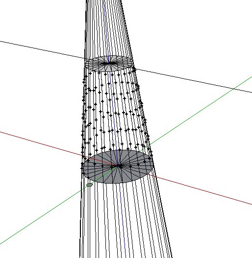

I'm sure their might be easier ways but this was rather fun. Here is a saved step along the way which shows the layout before I started to add the lines.
[ATTACH]2540[/ATTACH]
I wasn't all that sure this idea would work and it would be a lot of work for nothing if it didn't. I used a spread sheet to generate the data then away I went. Trying to keep track of which line was which made it even more fun. If I do it again I'd do a line then put the guide points then the next line etc.
