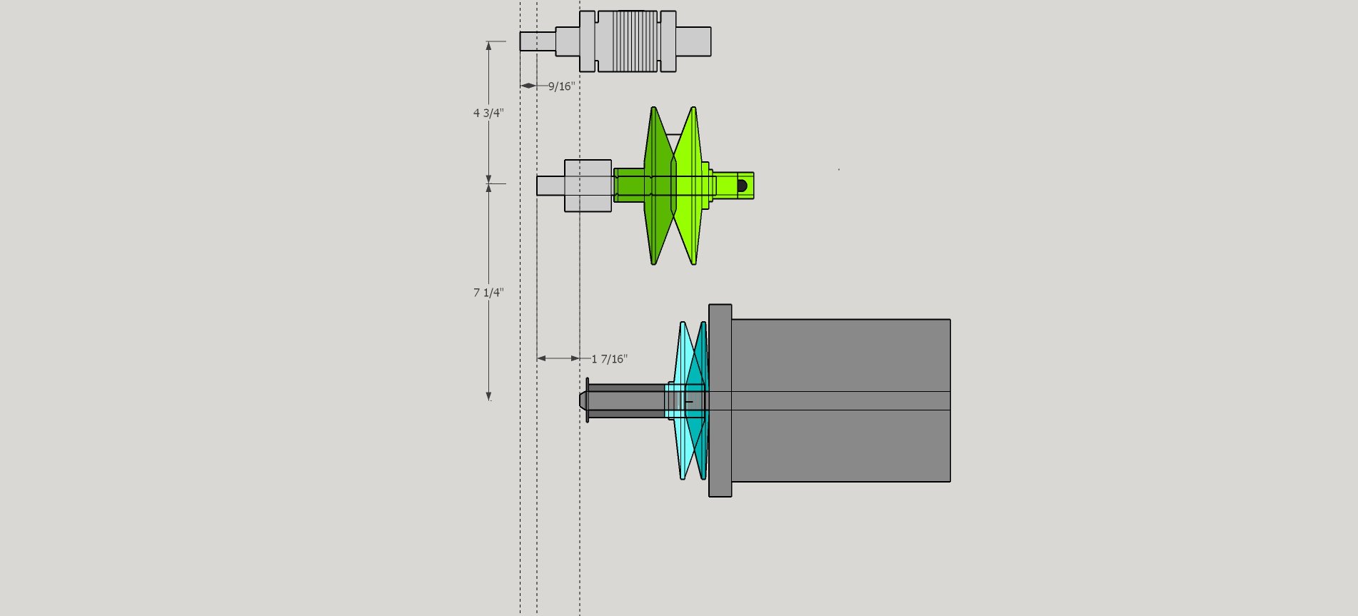

My issue began with a n attempt at High Speed Adjust (coupled with an observation of how the various sheaves are positioned with respect to one another).
At both high and low speeds my measured rpm are about 700 rpm high (1397rpm and 8472rpm). I have put that aside for now.
Based on some info regarding the non-adjustable sheaves (fan sheave and idler sheave) provided by JPG a day or two ago, I have contemplating all of this and I now have doubts about my assembly. I need to know how the three shafts are positioned with respect to one another. I think this disgram shows what information I am attempting to validate (4 measurements).
I have spare parts that can be used to confirm all other relative measurements. I doubt these four because there are inconsistency on my two machines

The 4 3/4" and 7 1/4" distances will vary inversely due to the rotational position of the eccentric. If your numbers above are accurate, the sum should always total 12" regardless of eccentric positioning.
The other two dimensions are suspect since what I stated earlier cannot occur and it IS necessary for correct speed range limits.
I cannot say for sure that the motor shaft has/is consistent through the past 7 decades.
I question the 9/16" since the idler poly-v pulley is too far out(idler poly-v pulley not centered on the drive sleeve poly-v pulley).
Would be a good idea to verify my 1" open recollection.

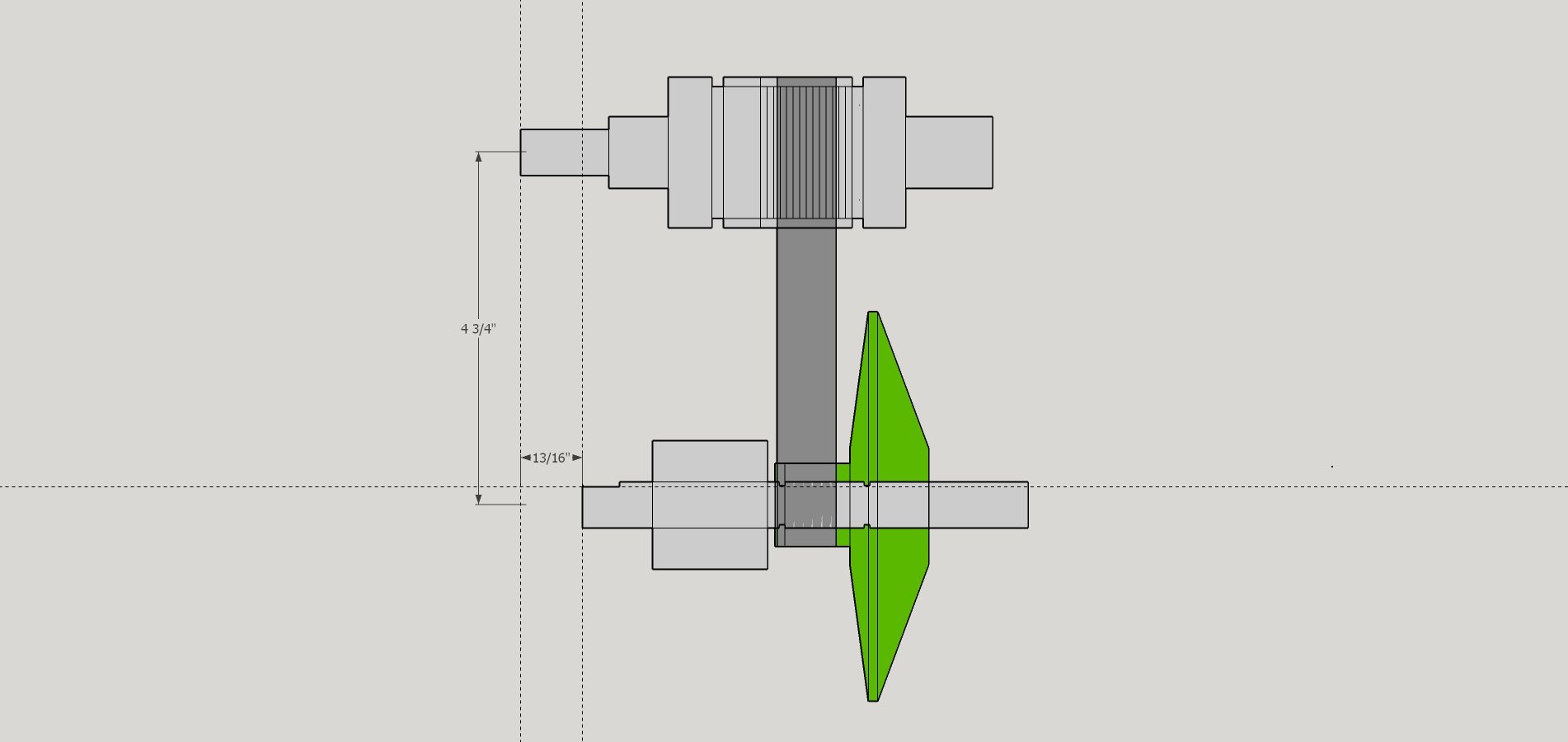

Thanks for the inputs. I have now revisited the SketchUps that I had, made a few corrections and am now in the process of reassembly. This is what I have so far. I have done this with the various parts close at hand; along with my digital calipers. The numbers may not reflect the universe but they do reflect the parts that I have and I hope the parts that are in my two machines.
- Drive Sheave and Idler Sheave Assembly Ver 1.jpg (66.37 KiB) Viewed 720 times

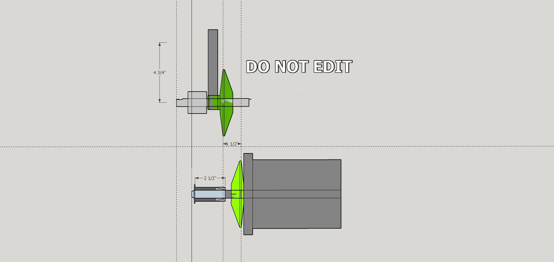

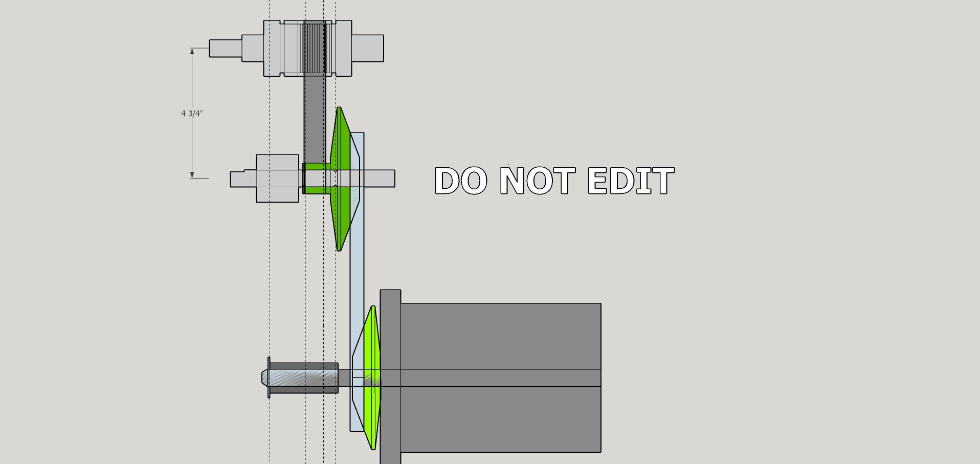

With assistance, I am making some progress in trying to "fully understand" the sheaves and how they work. However, I still have questions. The attached sketch shows the fan and idler sheaves; the two sheaves that are permanently fixed. The speed adjustment are based on these sheaves in conjunction with the idler and floating sheaves.
My question is where will the V belt ride on these sheaves with the speed adjusted for "mid-range); that is to say when both sheaves (pulleys) are the same size.
At what speed will this occur?????
(high speed - low speed)/2 = (5500 - 700)/2 = 2400 rpm
Set your machine for 2400rpm and look at the sheaves. They are no where equal in diameter.
