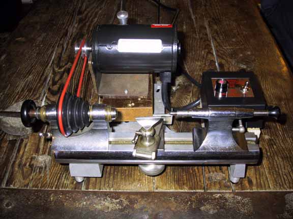

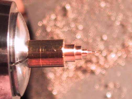

Much watch and clock work is done on lathes with hand gravers and a T rest. It isn't that different than turning wood and you can cut both brass and steel. Leaded brass is easier to machine.
[ATTACH]2557[/ATTACH]
[ATTACH]2558[/ATTACH]
Troy
