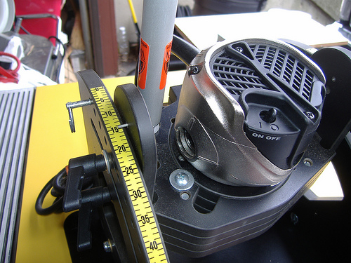

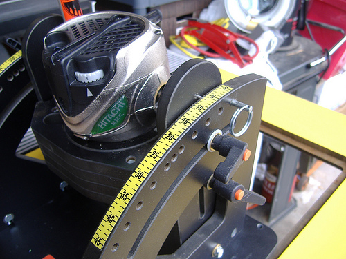

Had one more thought overnight. In cases where you don't have a lot of parts to do and you didn't want to reset things you might want to re-look at the router idea but with a twist or should I say tilt.
One of the things I own that has been a fun gadget and allows me to do some things that would be very hard to do other wise is an "Angle Ease". In concept it is a router table insert that has a part that holds the router either vertical or at an angle up to 45 deg. It fits in the jointech router table on my new system as well as an older jointech top I have.
It is not cheap and it doesn't fit every router but you can have a look at it here:
http://www.woodhaven.com/ProductDetail.asp?Id=2227
I have a couple of not so great pictures of it:
[ATTACH]2583[/ATTACH]
[ATTACH]2584[/ATTACH]
The advantage is you can use the bevel bits for the stock angles they have and use a straight bit and the tilt for other angles. I have never tried this but at least in theory it sounds like it might work.
Picture the bit tilted back into the fence when you look at it. I'd offer to give it a go but that would be months down the line when it warms up in the shop.
