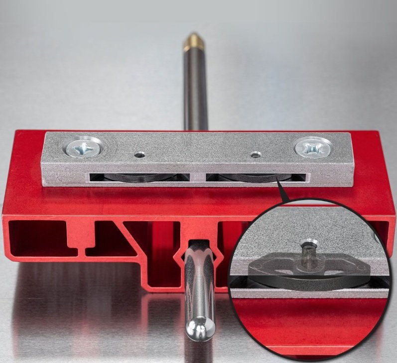

Set the fence, set the table to the blade, repeat width cuts and other things

Yeah, but what are the chances that it will fit in the non-standard Shopsmith miter gauge slot?

Possible, yes. Probable, not in my opinion. You would have to drill two centered holes and countersink them on the Shopsmith miter bars to attach them to this Woodpecker device. A lot of added expense and headache for this tool IMHO. It is possible that the existing Woodpeckers miter bar will fit a Shopsmith miter slot, but impossible to know without purchasing it and trying it. I didn't see any specs listed for the Woodpeckers miter bar that comes with it.edma194 wrote: Sat Oct 02, 2021 1:39 pm You can get a couple of Shopsmith Miter Gauge Stop Rods shown on the page below:

I always try to make all rip cuts needed at a particular width before moving the fence to do some other table saw operation. I don't think I've ever miscounted how many pieces I will need ripped to a particular width, but I have ruined a piece much later in the project and therefore have had a need to go back and make another rip to the original width. It's a pain in the neck that this tool could solve. But the thing is, if I had already made all the rips of a particular width I thought I'd need, I'd probably not bother to use this tool to take a measurement before I moved the fence.
As a tool for checking rip fence alignment or blade alignment, I think I still prefer a dial indicator-based jig.
So I don't see much use for this tool in my workshop.

Thanks Alan. Yeah, I had the same thoughts on this one. I don't see it being useful for repeating a particular rip cut and it isn't clear to me what advantages this has when setting up a rip fence for calibration over using the tried & true dial indicator setup. When I saw Woodpeckers release this one, I just shrugged. Of course, if someone sees a benefit to this tool that I am missing, then please let me know.algale wrote: Sat Oct 02, 2021 3:35 pm As a tool for checking rip fence alignment or blade alignment, I think I still prefer a dial indicator-based jig.

They are interesting...but even if you make 1 cut, change your fence to something else...cant you simply use that first cut you made as the exact reference?

I emailed Woodpecker and they replied that the new tool will not fit the Shopsmith slots. Still it wouldn't take a lot of effort to power sand off a small amount on the back side of the bar to make them fit. I did that with the Rockler thin strip guide.

A detail to consider. Most TS have a fixed distance from the slot to the blade. SS - not so.
