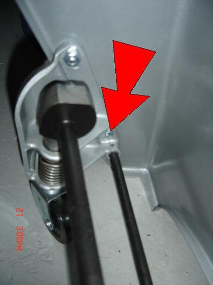

The Lower of the 2 bars going across keeps the casters pulled together. You will want to look for a sheared or missing roll pin on either side. You could also try and bed the legs of the machine inwards to try and hold it tighter together. Mine had both sheared and missing roll pins along with the sides being spread out alot. Hope it helps. Josh
- arrow.JPG (26.1 KiB) Viewed 18480 times
