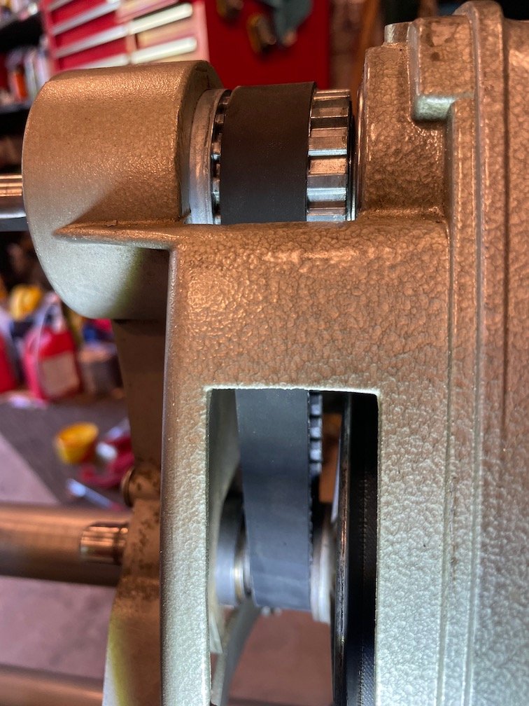

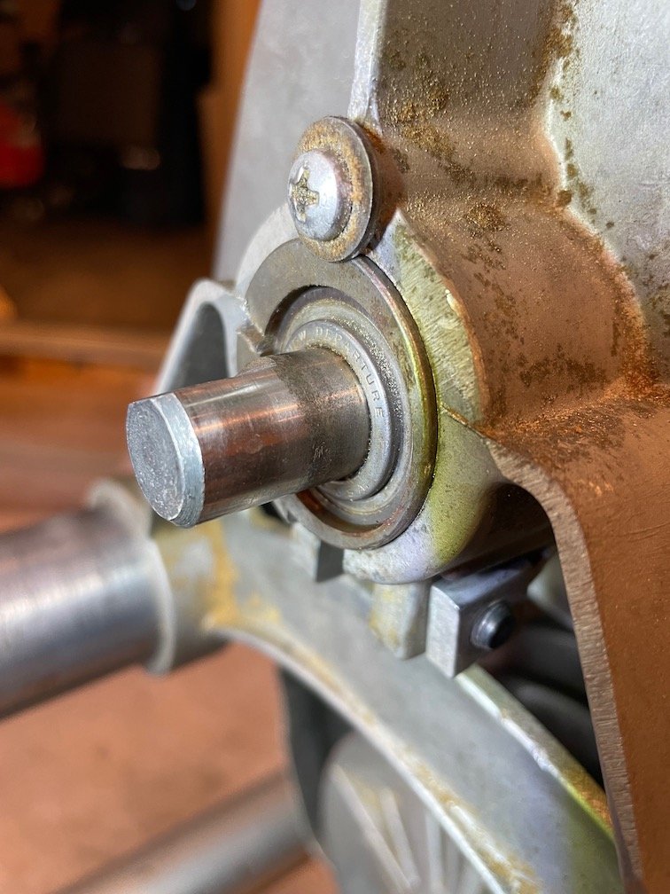

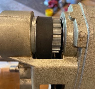

I've installed the new gilmer belt in my headstock, however I'm a little concerned about the alignment. It's riding up against the shoulder on the outboard end of the cog. The old one did the same before it broke.
Should it be more centered? And assuming yes, how would one adjust it? I don't see any provision for that. The idler bush seems like it should abut the stop screw, and the idler bearing has a groove to accept the point of the grub screw, so everything seems to have a fixed position. And if I were to move the idler position, it would affect the v-belt alignment. What am I missing here?

Post a pix that includes both ends of the belt(drive sleeve etc., and idler sheave, and end of idler shaft etc..
It does tend to track there!

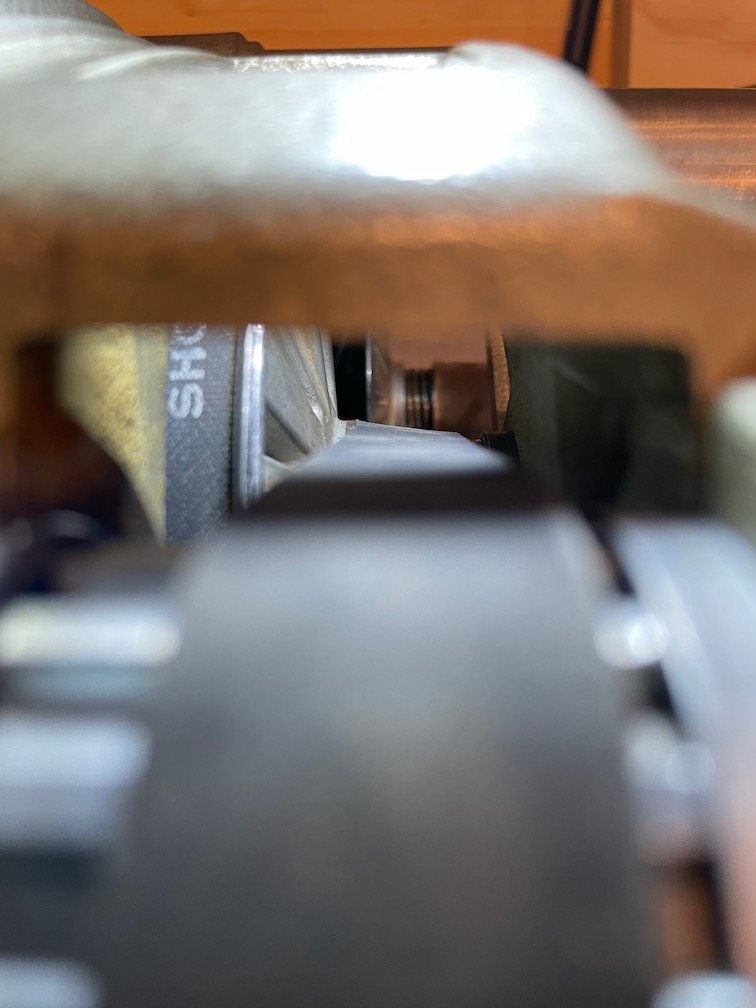

It seems like the idler shaft and drive sleeve axes are not parallel. The idler seems like it's "tipped up" slightly on the sheave end, making the outboard side of the belt a little tighter than the inboard. Maybe the pictures will show what I'm talking about. I was able to get a little breathing room on the drive sleeve cog by scootching the bearing inward in the offset bush but I don't like it.

First, full disclosure, my Gilmer machine appears to be worse than yours. I haven't done much with it in recent years, and it's pretty rough. The belt always rode where yours started.HopefulSSer wrote: Thu Oct 21, 2021 11:27 am It seems like the idler shaft and drive sleeve axes are not parallel. The idler seems like it's "tipped up" slightly on the sheave end, making the outboard side of the belt a little tighter than the inboard. Maybe the pictures will show what I'm talking about. I was able to get a little breathing room on the drive sleeve cog by scootching the bearing inward in the offset bush but I don't like it.
As part of a PowerPro rabbit hole, I found I could measure the angles of the shafts by putting a lathe faceplate on them and measuring the relative angles of them. With any luck at all, the face plate will be extremely close to normal to the shaft. I used two 3-3/4" face plates but I think the larger one would work as well. I used a Wixie to measure the angle, there are many alternatives. There are some pretty good smart phone apps, though they can't publish accuracy. (I don't like to use my phone for things like this out in the shop due to potential for dropping it. Wixie or competitors are relatively cheap and durable.)
It's important to make sure you are using a Gilmer belt tension procedure. IIRC it will should have somewhat less tension compared to a Poly-V.

Gilmer belts can slide side to side along the cogwheel unlike the multi-groove belts. If it's not wearing out the side of the belt from contact then you should leave it alone until you can identify an actual problem in operation.

I'se a bit confused. The third pix above shows a poly-v idler pulley??? BTW it is one groove too far towards the back(s/b two vacant grooves on both sides)(pulley has 13 grooves - belt has 9 ribs.
Second pix-The eccentric is NOT fully inserted(washer should be flat against it)(would do the same as you did with the bearing).
I assume you moved the bearing away from the set screw positioning??

I'm not seeing that.JPG wrote: Thu Oct 21, 2021 2:33 pm I'se a bit confused. The third pix above shows a poly-v idler pulley??? BTW it is one groove too far towards the back(s/b two vacant grooves on both sides)(pulley has 13 grooves - belt has 9 ribs.
- David
Re: Gilmer belt alignment
I think "THEE" are more observant than I. Yes I was referring to the motor shaft spring.
