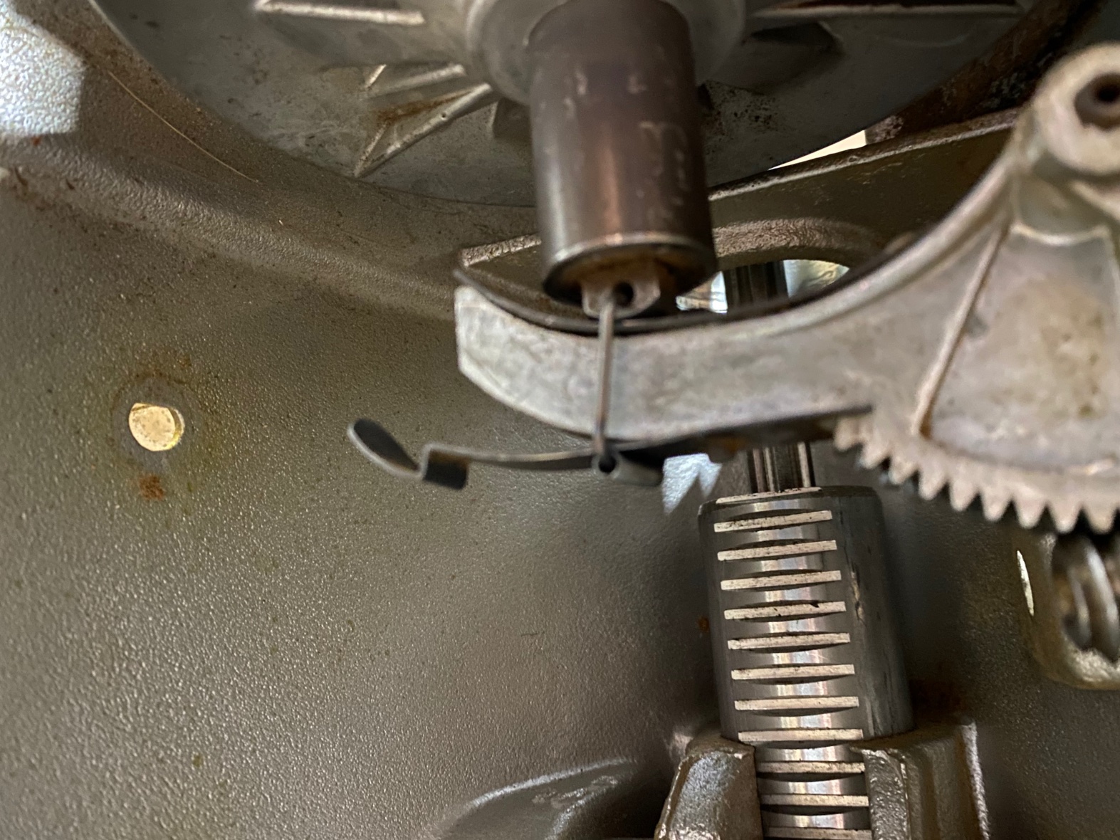

If you don't need the Button or Button bearing, I believe Shopsmith does sell the Retaining Loop by itself, 504187. There is some uncertainty here because the exploded parts diagram and parts list are not in agreement: https://www.shopsmith.com/service/headstock/index.htm Failure of this part would usually indicate a failed button bearing or other problems.

I am not aware of any other bearings used in a Mark 5 quill. The quill IS different on the splines.
A failing loop can be caused by insufficient lubrication of both movable sheaves or too aggressively adjusting the speed upward.
The purpose of the loop is NOT to pull the control sheave, but to prevent rotation of the center race of the button bearing.
If the floating sheave is slow to respond(lack of slippery), it will cause the control sheave to also be slow to respond.

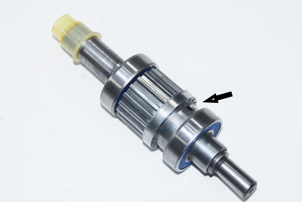

Welcome to the Shopsmith Forum. Please don't feel overwhelmed already. We really can help it is just that we need to see what you have to provide the correct information. Pictures as has been already recommended will be a great help to us to know what, if any, upgrades or changes have been made to your Mark 5 "Greenie" over the years. Include pictures of the drive sleeve, the idler pulley assembly (front and back) and the entire quill after removing it from the headstock. Upgrades are a common occurrence and there are many variables that could have been changed on your Shopsmith. Something to remember about the Mark 5 is that all changes/upgrades have been backward engineered so earlier tools can have these changes added to them. I won't say it cannot be done since I have never tried it but using a poly V belt on a Gilmer drive Mark 5 wouldn't work very well if at all.
For your reference, below is a clutch type Gilmer Drive Sleeve Assembly. The arrow indicates the set screw in the collar used on all clutched Gilmer Drive Sleeves. Those having a set screw in the gear teeth are the non-clutched Gilmer Drive Sleeve Assemblies first used in the Mark 5 in 1954.

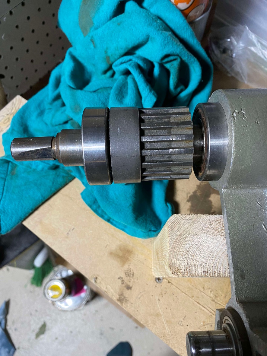

THANK YOU ALL for your replies. After I tore it down I def felt a little overwhelmed. The old owner did not say anything about making modifications, maybe he replaced the belt and thought it was the right one, but it def was not a gilmer belt. n Still looking for help finding the bearings for the Gilmer drive sleeve and the single quill.JPG I am not aware of any other bearings used in a Mark 5 quill. The quill IS different on the splines.
Here are 2 pics, first is the part I need to get the gilmer belt for, anyone have a good link for a good priced one?
Second is the clip I was looking to replace. I think, again the older owner, prob did some adjustments wrong and bent it. I was able to bend it into position, then heated it up and quickly cooled it. Seems to be staying in the right shape, everything I tried before heating didn't work.
