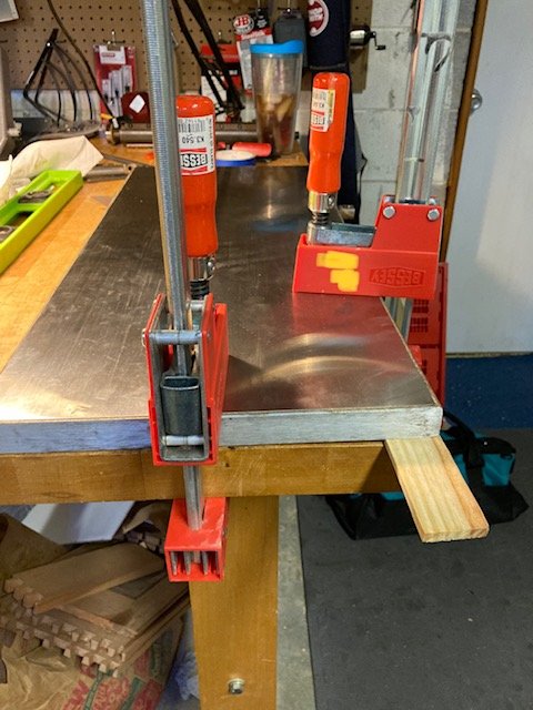

I ended up disassembling the planer after noticing that the table mounting posts also looked bent. I suspect that may have also occured when the planer table got damaged. So I'll be replacing all 4 table mounting posts...
Since I had the machine apart I tried using a shim and some bessey's to make the planer table level (flat) again. I went very slowly/gradually and it worked really well. Its all but dead flat now and it didn't cause any damage/cracking to the case aluminum either. Very happy with the results here. I won't say I recommend this to others as it could certainly crack the cast aluminum. But I went slowly gradually raising the shim and it seems to have worked out.
