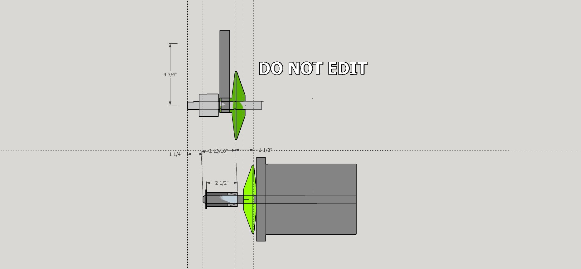

Very, very interesting. Is it possible that the sheaves are improperly oriented,
I sure am curious about some possible alignments (not adjustable).
Idler Sheave and Motor Sheave Assembly Ver 1.jpg (72.62 KiB) Viewed 2546 times
This is a sketch of the sheaves in my Mark V. I did this before I began a tear down. The numbers are accurate though THEY MAY NOT BE CORRECT. It does seem to me that the drive belt would travel in a plane perpendicular to the shafts and it does not.
Aligned as it is would certainly create more heat than it would if it rode centered in the sheaves.

As for belt/sheave misalignment - well small variable misalignment are SOP with variator-type drives like these, and v-belts easily soak up such misalignment, so I don't think misalignment is the source of the problem.
