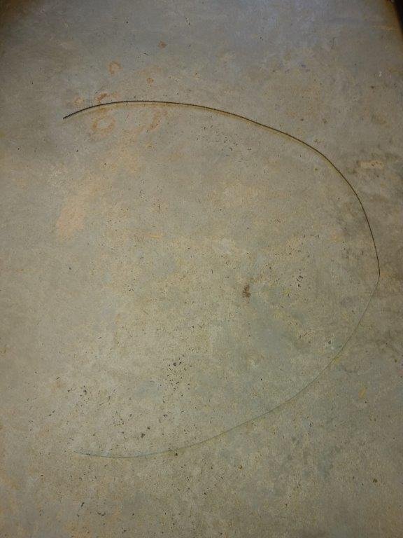

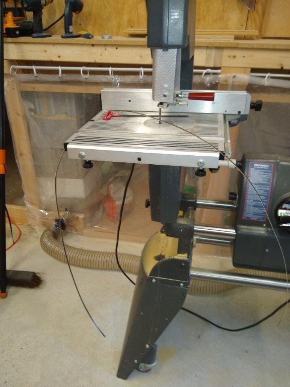

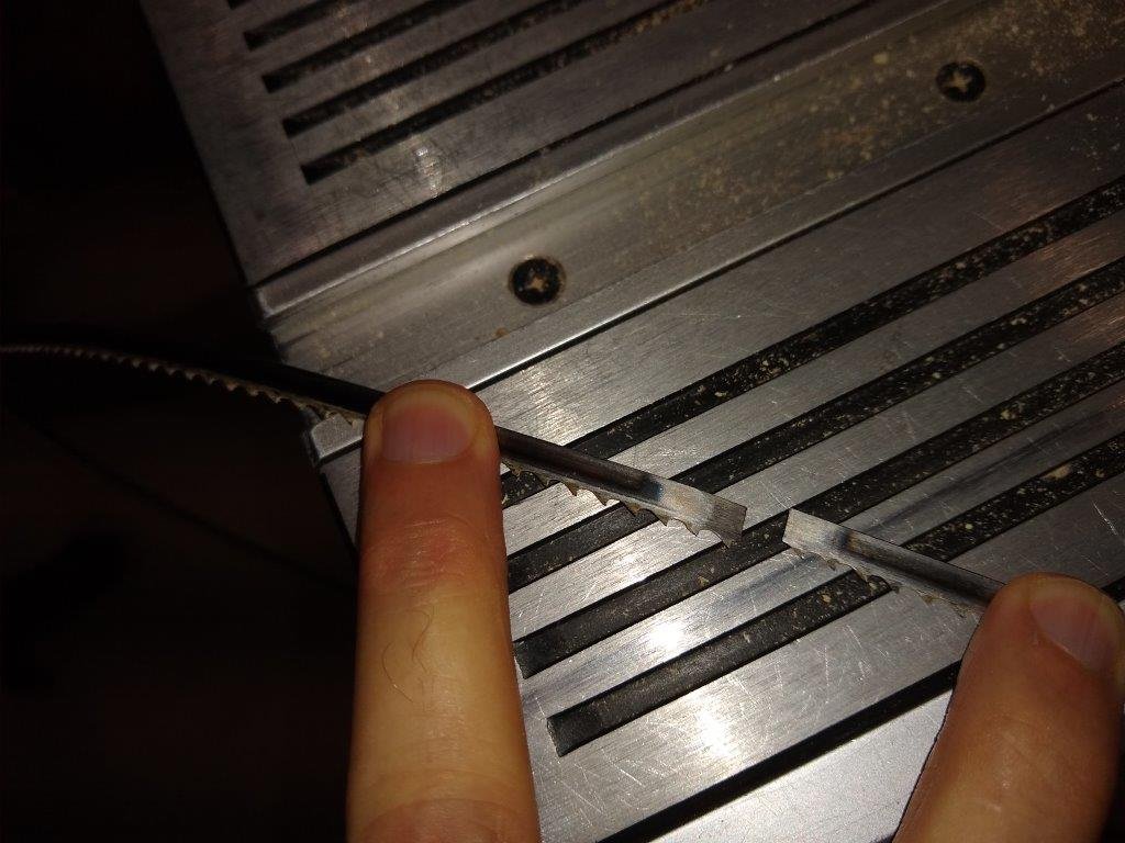

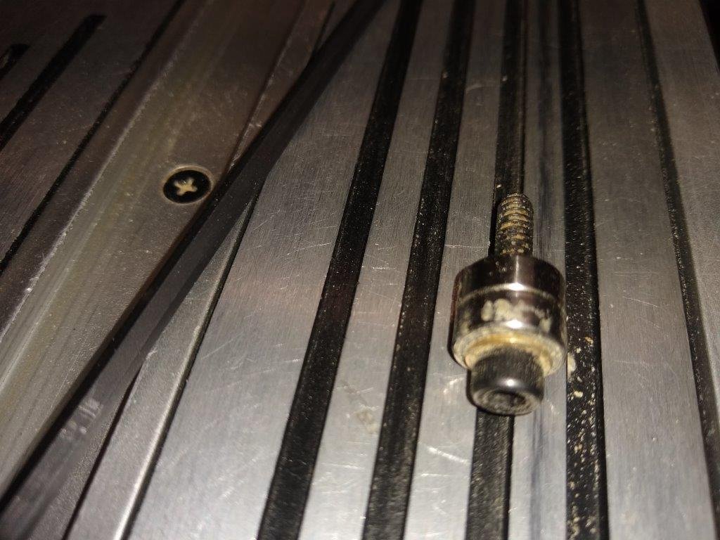

Heres some forensic pics for you detectives
It does appear to have broken at the weld.
It does appear to have a kink in it as well-though I dont recall that being there when I installed the blade a day ago.
There seemed to be some amount of wood pulp smashed into one of my lower bearings-possibly indication of a splinter getting in between the blade and roller?

Yeah, the welds are the weakest link on bandsaw blades, so not too surprising that that is where it broke. Also, the kink in the blade may have happened after the blade broke, so I would suspect the blade is the culprit, rather than anything that you did wrong. JMO.
If you get a new blade and it happens again, after confirming the guides are positioned well, then that is when I would take a step back to try to figure out what, if anything, you are doing wrong.

Since your blade was fairly new with low hours on it, I think that tends to confirm a bad weld from the manufacturer. Advice I found on another forum indicated that likely your bandsaw blade was not sufficiently annealed. The process of welding hardens the steel and leaves it very brittle. Bandsaw blades have to go through annealing after welding to soften the weld metal to prevent a premature failure like you probably experienced. The manufacturer will likely stand behind their product and fix this. IF they give you a hard time, I would ask them about their welding process and how they anneal the welds afterwards.
