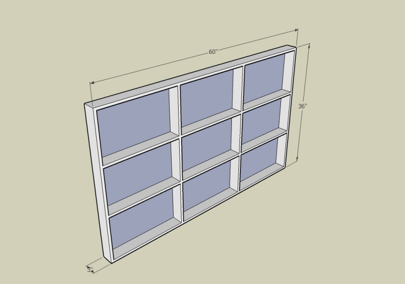

This is my interpretation of what you said you need. Is it close?
The vertical separation between shelves seems to be too large unless you are using rather large spools of thread. Are these sewing machine spools or are they embroidery machine spools. How tall are the spools? How many spools do you intend to store on this rack?
How tall do you intend to make the dowels? Why dowels at all; would the spools not just sit on the shelf without dowels? I assume this rack will be hung on a wall; it is too narrow to free stand!
[ATTACH]2695[/ATTACH]
http://www.shopsmith.net/forums/attachment.htm?attachmentid=2694&d=1230383918
- Thread Rack.jpg (69.04 KiB) Viewed 7905 times

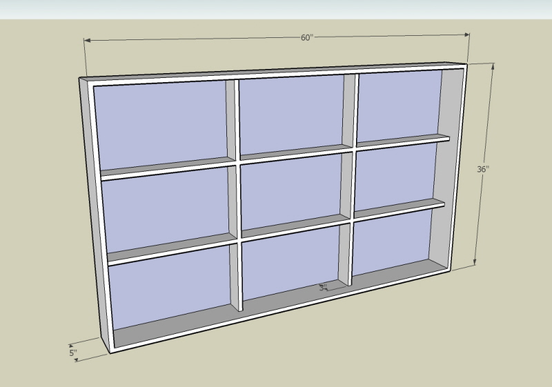

I reread what you had written and my first interpretation may have been incorrect. Is this closer to what you are thinking?
[ATTACH]2701[/ATTACH]
- Thread Rack Revised.jpg (79.96 KiB) Viewed 7923 times

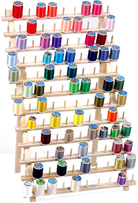

Dusty, I think it might be more like this.
The size is, Measures 12.5 x 15.5 x 2 inches.
[ATTACH]2719[/ATTACH]
- 47582315.jpg (67.95 KiB) Viewed 7912 times
She may change her mind when she sees this; it certainly looks like a neat rack.....but....it sure doesn't fit the original description.beeg wrote:Dusty, I think it might be more like this.
That's a really neat drawing. What program is that done with, Beeg?
Why don't you go back and put some dimensions on it?
That was a jpeg copied off of the Handcock Fabric site. BUT I think Rose wants something LARGER. Like 5 X 3 foot.

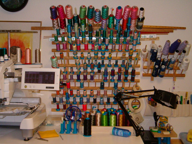

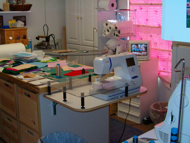

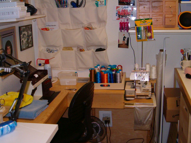

Here's a photo of the one built for my wife's sewing/embroidery room. It measures about 2.5 ft. wide by 3.5 ft. tall. (The aluminum ruler showin near the top of the rack is 3 ft.) (In the 1st photo, you can see an old store bought one to the right of the larger one.)
At the time, 5 yrs ago, it was large enough to hold all of her large spools. Rather than loose more wall space, she came up with the idea of adding plastic straws to the pegs so she could stack the spools. She is quite inventive.
She soon became aware that when she had several spools off of the rack, she needed a couple of trays to hold those, so the didn't just roll around. There is one tray in the first pic and another in the second pic.
Another space saving idea she came up with is a couple of folding leaves. I used folding brackets from Rockler that support about 750 lbs per pair. A little over-kill, but they work well for multiple purposes. (See 3rd Photo) http://www.rockler.com/product.cfm?page ... 20brackets
Another cute little thing is the scissor,etc. holding device she made by gluing medium sized empty spools to a piece of Masonite. (Photo #1)
The joints in the larger thread rack were made by dadoing off the edges of the back cross pieces at a 45 degrees, then gluing and stapling the cross bars to the up-rights. This way the pegs protrude at a 45 degree angle. (space saving)

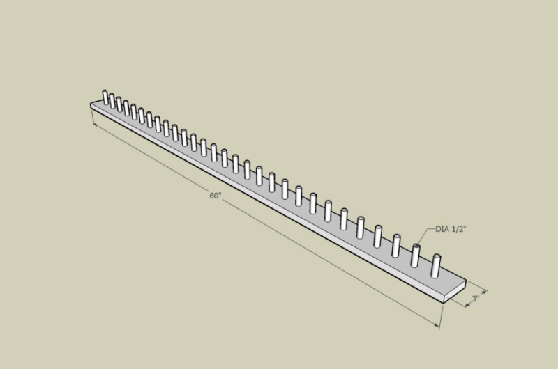

Thread Rack, Different Approach
Someone suggested that the spools needed to be supported. Probably a good idea.
Here is an approach presented by another drawing. I would suggest installing these on the wall or in a cabinet at an angle (about 45 degrees).
I'm having fun and learning a bit more about Sketchup so I'll probably carry this on still further. I gotta be careful though or I'll find myself redoing the ones I made last summer for my daughters Traveling Embroidery business.
[ATTACH]2788[/ATTACH]
- Thread Rack Bar and Dowels.jpg (39.74 KiB) Viewed 7814 times
