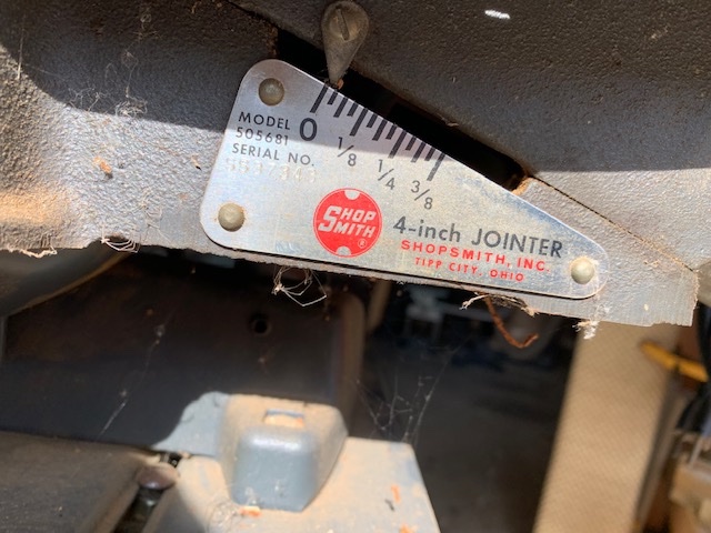

I know, you all warned me. I couldn’t resist a good CL deal (I think). I lady was selling her father’s Power Stand mounted Jointer and they were in decent shape. I don’t really need a second jointer, so I will probably sell one of them, and most likely the one I just refurbished. Although the serial number is only 20,000 higher than my “old” jointer, I think the newer one is mechanically in better shape, overall, it looks like it has seen less use. Since the cutter heads are the same, I’ll probably swap with the one I just refurbished; I know it has new bearings. Still, the one I just picked up is going to require some rust removal, but it’s in a lot better condition than the other one was.
I have a couple of questions:
1. Is there a way to tell the year this jointer was made from the serial number? It’s s/n is 37343.
2. What years were the SS Power Stands sold?
Here are some photos of my “new” tool:

October/November 1981 on the 505681 jointer.

The Jointer was made in October 1981 By Shopsmith Inc. and note the SS in the serial number. There was a Jointer serial number 37343 made in November 1955 by Magna Engineering Corporation. Your new to you Jointer is a lot more than 20,000 units newer than your old Jointer and more like 80,000 roughly. This is a case where noting a prefix with the serial number and even who made it is important. Since Shopsmith Inc. restarted serial numbers at SS1001 when they began most Mark 5/V and SPT's repeated the serial numbers.
