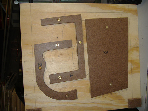

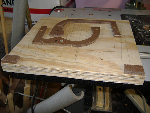

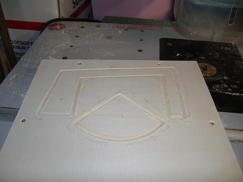

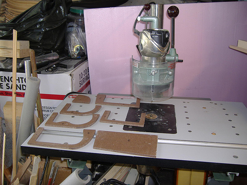

Hi,
These are some of the photos related to pin routing using the old OPR. This is a lot like what can be done on the new version so I figured it might be nice to save these from the bit bucket as I clear out my Flickr account.
I have several other batches I'd like to add here, we will see how that goes. This first batch is related to model airplane parts. The pattern pieces were cut from full size plans then glued to tempered hardboard then cut on the jig saw then sanded to finish. The rest should be conveyed by the pictures, if not you can always ask.
[ATTACH]2713[/ATTACH]
[ATTACH]2714[/ATTACH]
[ATTACH]2715[/ATTACH]
[ATTACH]2716[/ATTACH]

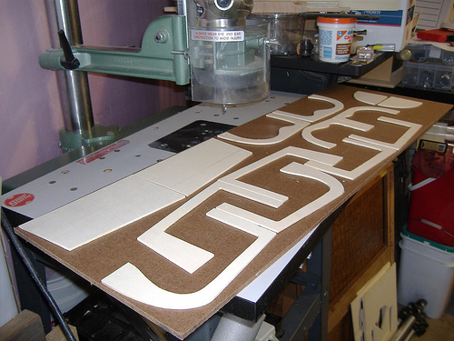

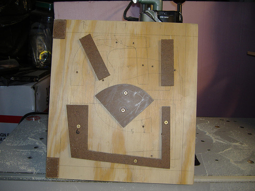

More to follow.
This is the last batch of this group of pictures. I hope to add some more of the parts I pin routed for the plane in the next few days.
[ATTACH]2717[/ATTACH]
[ATTACH]2718[/ATTACH]
