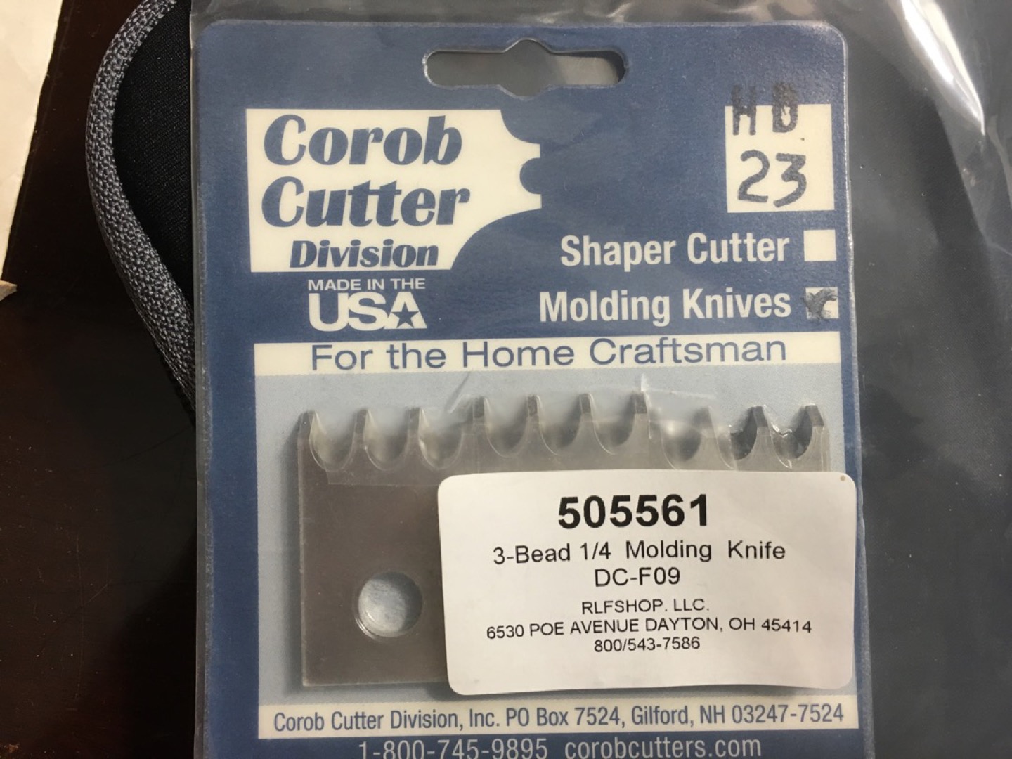

I think that statement is true of the old Shopsmith knives with the new Shopsmith head or the new Corob knives with the old Shopsmith head. But sInce Corob branded cutters actually shipped from Shopsmith for the newest molder head, I think the new style Corob knives work with the new Style Shopsmith head.
See this photo? Corob brand from Shopsmith (RLF Shop).

I think Corob branded cutters actually shipped from Shopsmith for BOTH the old and new molder head. Which adds to confusion. I have 505564 and 555038 new in Corob packaging, both still listed for now on the SS site as "older-style." But your photo appears to have a Corob PN HD 23, mine have only the SS PN. Does you new-style SS molder head have a Corob PN on it? I'm thinking it is what Corob refers to as Delta.

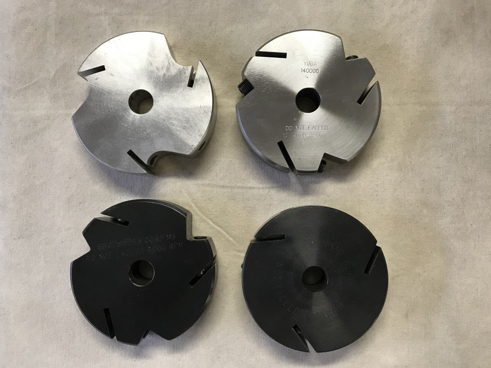

Thanks for the information, guys. I guess since they were selling someone else's Molder Head and Knives they decided to stop carrying them in the catalog. The old Molder Head styles all allowed a direct connection to the Shopsmith's spindle with a set screw. No need for an arbor. The original Shopsmith Molder head was also made for Montgomery Ward under the Powr-Kraft brand but did require an arbor. In the picture below of the old-style Molder Heads it is the upper left Head.
_
Molder Heads.jpg (174.46 KiB) Viewed 4343 times
I believe the knives for the newer Molder Head (September 2011 and later) are thicker. I have not seen, other than pictures, the newer head or knives. The picture above is my older style Molder Heads and all the versions made.
