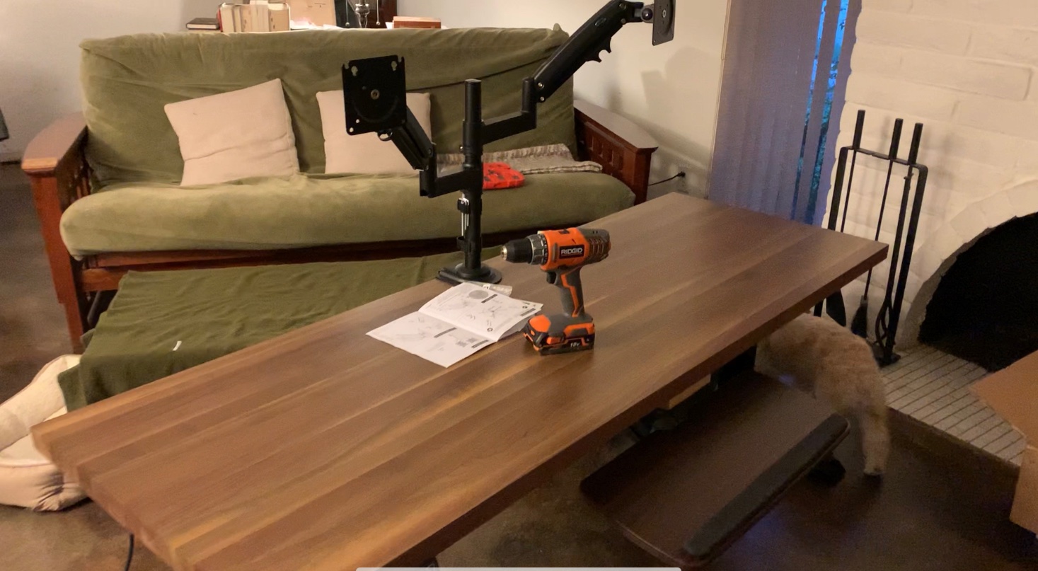

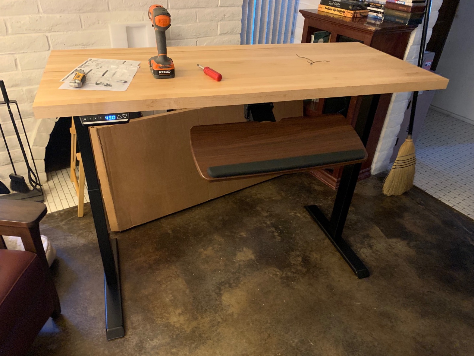

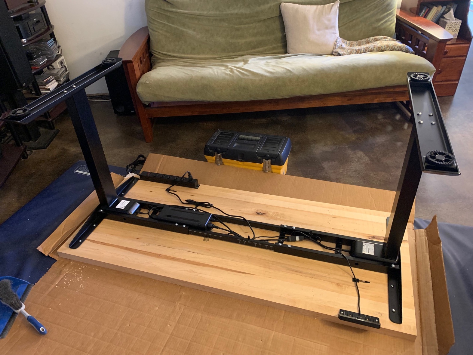

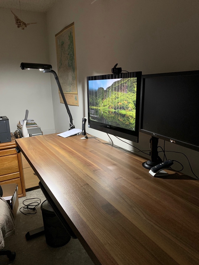

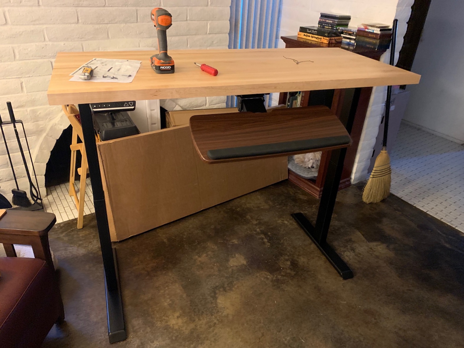

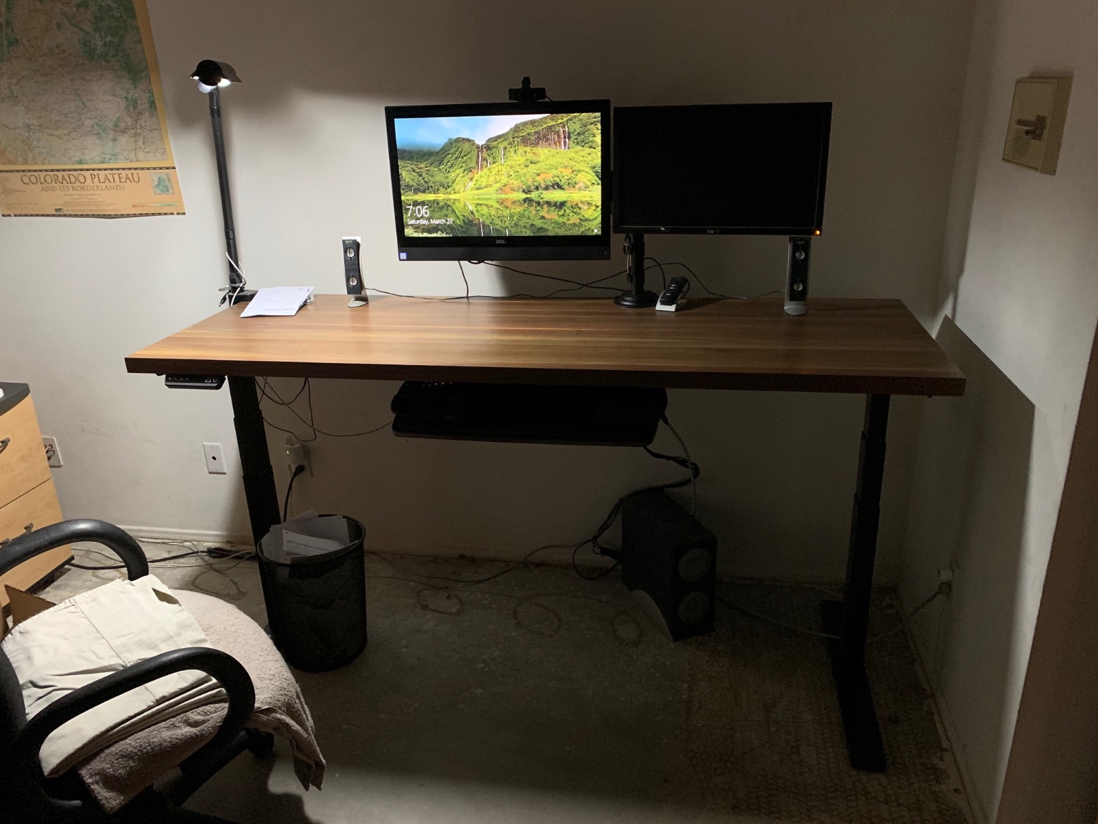

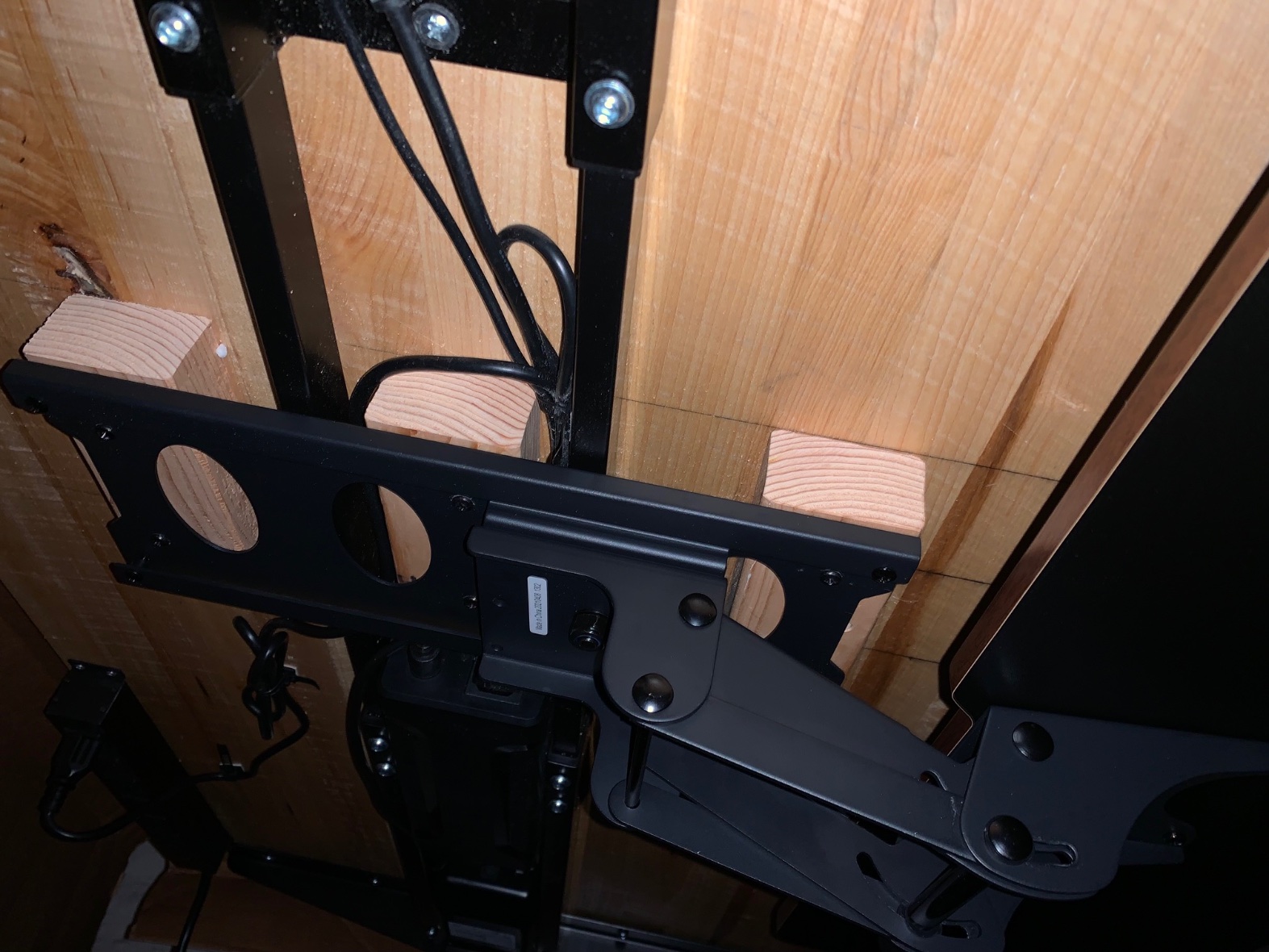

This is not really a woodworking project, although it is related. Back in March or April I built a motorized standing desk for my spouse because of all the time spent in meetings on Zoom. Well, they’ve returned to campus so it’s time to build another one.
Back in the winter I found an excellent motorized stand, a 60”x25”x2” walnut butcher block style table top, a half decent sliding keyboard shelf, and a very good desktop mounted pneumatic activated dual monitor stand to support the heavy all-in-one computer and a wide-screen second monitor.
One of the projects I’ve had on hold, due to other more urgent projects getting in the way, is building a walnut keyboard shelf that will hold the large ergonomic keyboard with space for the mouse. The keyboard shelf mechanism is very good, but the shelf itself is not only too small, but it’s also a piece of crap. So, I’ve designed a shelf that is the correct size, will have a slight slope for the keyboard, and an inset mouse area that will help keep the mouse from falling off the shelf. I have designed and built the jig and patterns for routing the sloped keyboard area and the shallow mouse inset, but I still need to build the router sled before I do the actual work on the walnut board that I have. Anyway, that’s been on hold for several months.
Well, since the community college faculty and staff are going back on campus at least 50% of the time, and someone has been spoiled with the standing desk, another one needed to be built for the office. That is what I built today. I the same parts, but got a maple butcher block table top. I did have to use the ShopSmith to cut 6” pieces of 2”x3”, which were used as spacers to allow the base of the keyboard shelf to mount over the cross-supports of the standing desk frame.
Below are some photos of the the desk; first the underside of the desk, before mounting the sliding keyboard shelf, and then two shots of it completed (minus the monitor stand which is already on campus) with the desk at full height and as it is descending.

It’s almost woodworking; I did cut some 2x3s on my ShopSmith (3 cuts) and drilled a bunch of pilot holes for the screws. I got the idea for this desk from a job I was involved with a couple of years ago where we moved a large client who had hundreds of a similar style of motorized desks. My job is typically working on servers, business class firewalls, and cloud servers, but the company I work for was tasked with setting up all the PCs at the new desks, so it was all hands on deck for this job.
First of all, it’s not a cheap desk but making it yourself is probably half the price, or better, than if you were to buy it from an office furniture store. I think we spent around $600 to $700 for the parts. One of the great things about this desk is that you can easily program three height settings; we set positions for sitting, standing, and then all the way up, which makes it easier to sweep under or work on the bottom of the desk.
The 60”x25” butcher block top was purchased at our local hardwood lumber yard. I don’t yet have the skill to build that myself, but you can certainly save some money if you can do that. The first desk I built was made from walnut, and I think it’s beautiful (see photos below). We wanted to save a little money on the second one so we chose maple, as you can see in my previous photos.
There are a few things to keep in mind as you build the desk. Unless your power outlet is right behind the desk, the power cable is a little short. Even if the outlet is close, you won’t really want all the cables draping down the back as the desk goes up and down. I mounted a surge protector to the bottom of the desktop, in the back, and close to the side where the outlet is located. This allows one power cable to drop down at one side of the desk and all the devices on the desk can plug in where you can easily hide those cables.
Another thing to keep in mind has to do with installing the keyboard shelf. Where the sliding keyboard shelf would mount to the bottom of the desktop, the frame of the motorized base is in the way. I just cut three 6” lengths of 2x3s and screwed them to the underside of the desk to act as sturdy stand offs. I placed the front edge of the sliding shelf mount about 5” back from the front of the desk so the keyboard shelf fully slides under the desk. Don’t go too far back as the keyboard may not fully extend out from under the desk. The sliding shelf hardware is heavy duty, but the shelf itself is some form of manufactured wood with a plastic wood grain laminate. It’s fairly decent looking, but I feel a desk of this quality should at least have a real wood shelf that matches, so I’ve designed one that I am in the middle of making. At some point in the near future I will post my design, photos of the jigs/patterns I am making, as well as the completed shelf.
Here are the parts I used for the desk:
Motorized Standing Desk Base - The price fluctuates, it was $279 when I bought it a couple of weeks ago, but today it is $359. It is good quality, and a decent instruction book. It has a motor on each leg to extend the legs.
Fromann Electric Stand up Desk... https://www.amazon.com/dp/B08DT8RHL2?re ... b_ap_share
Sliding Keyboard Shelf -
HUANUO Keyboard Tray Under... https://www.amazon.com/dp/B08CKZJ2WT?re ... b_ap_share
Dual Monitor Arms - They also have them with three arms.
ErGear Dual Monitor Arm, Adjustable Gas Springs
https://www.amazon.com/dp/B08BHJP422/?c ... pldnSite=1#
Power Strip - I originally got this for my shop but still had not mounted it, so it was available for this project.
Metal Wall Mount Power Strip, 15A 125V 1875W
https://www.amazon.com/dp/B081MZXG9L/re ... UTF8&psc=1

It was a fun distraction to build. I was so focused on completing the project that I hadn’t thought of other uses; you’ve given me something to think about. They claim it’s rated for a 225 LB max load. I don’t think we’ve ever had more than 100 lbs on ours, including the wood desktop, all-in-one computer, extra monitor, books, papers, and other small electronics.
After I set up the first desk I was taking videos of it going up and down, playing around with it to test it, and showing it off; after several minutes of use, maybe 10 minutes, it stopped with an error code. But that was a lot more than normal use. I had overheated the motors and it cutout for a few minutes to cool off. It also has a safety overload that is supposed to cutout if something is blocking it as it is descending, or if you put too much weight on it. But in normal use, even with several consecutive ups and downs, it has never done that again. You just have to be careful not to play with it too much.
