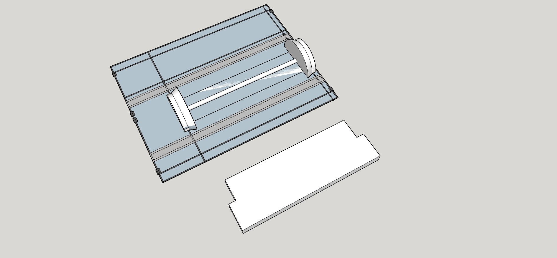

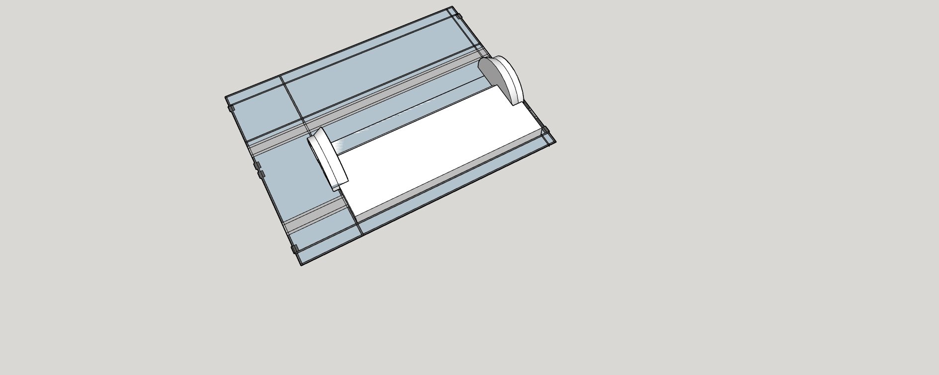

After watching Jim McCann discussing Main Table Alignment prior to the Table Assembly being installed on the Shopsmith I was prompted to resurrect this jig approach. I gave up on this back when I was striving for alignment accuracy to within .003". In one of the videos it is stated that the factory now alignes to within .010" over 10".
I think this can be done with a block of wood.
Main Table Alignment Footprint.jpg (102.67 KiB) Viewed 1649 times
Main Table Alignment Foorprint with Jig.jpg (68.38 KiB) Viewed 1643 times

The simple block of wood in my two images captures the two trunnions and a rib on the under side of the table. Holding that position while securing the trunnion bolts is what completes the table positioning. The miter slots in m,y two tables have been verified to be parallel to one another AND are parallel to the rib on the table. That is the reference for adjustment.
Everything else is dependent on the inherent accuracy of the remaining assembly.
Jim has stated that the factory alignment of the table is now completed prior to it having been mounted (onto the carriage) my words NOT Jim's. If I read that right this will work.
I've played with this and other similar methods for years and I no longer believe that the dial indicator (.003") solution is the only way to achieve what we need.
Shopsmith will never buy into this and I understand that. There are too many legal applications.
Others will not buy into this believing that the stacking of tolerances makes it impossible and I understand that.
I lived a goodly part of my life as a quality production engineer in a manufacturing facility with the DoD as our customer. I am equally convinced that it can and will work. Time will tell. Unfortunately I no longer do the amount of work in the shop to validate the theory quickly.
Cutting a few pieces of wood with no burn marks, no saw tooth marks, no binding and easy to achieve 22.5 degree cuts will be my checkered flag.
