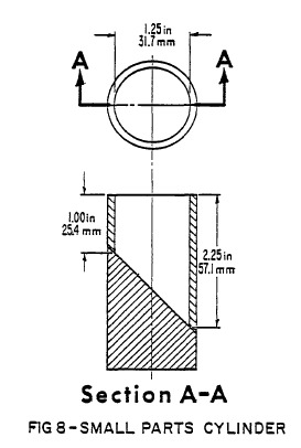

Small Parts Test (Toys intended for children under 3 years of age)
Using the government's “Small Parts Cylinder”, do any removable parts fit entirely in the cylinder?
For example, the smallest of the toy building logs could possibly fail this test.
NOTE: Some toy safety groups feel that the standard Small Parts Cylinder is too small to adequately protect young children from choking hazards and suggest that parents use the cardboard tube from a roll of toilet paper as a test device. Also please note that there are separate stricter requirements for small balls 1.75” in diameter or less.

Maybe one of our Sketch-up capable folks could build a standard Small Parts Cylinder model. :rolleyes:
