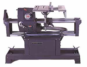

As David said there is a difference in what you described. The Mark VII was only made in the 1960's and is the Shopsmith shown below.
MARK-VII_SS Inc.jpg (10.62 KiB) Viewed 1305 times
