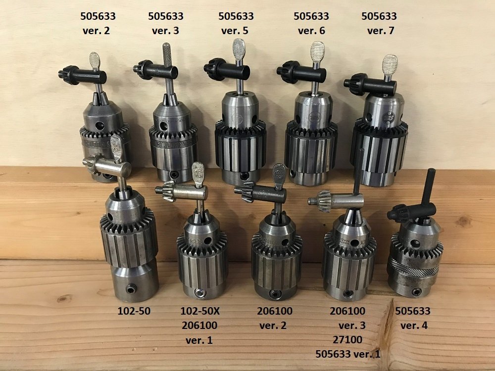

Note the change in set screw socket size between Ver 1 and Ver 2. 3/8 to 5/32
Version 2 still has the 3/8 set screw whereas Ver 3 changes it to 5/16.(caused by screw standardization).
A lot of 'unique' older screws were made before the standardization. SS had to change them so as to continue compatibility with the SS tool kit (5/32 hex wrench).

JPG,
If you are referring to Drill Chucks P/N 206100 version 1, 2 & 3 they each have different set screws which is what changed on them. Version 1 is from the Model 10's with a 3/8" set screw using a 3/16" Allen wrench. Version 2 is the first Mark 5 Drill Chuck with a special 3/8" set screw using a 5/32" Allen wrench. Version 3 has a 5/16" set screw using a 5/32" Allen wrench as do all the following Drill Chucks through the current one shown above. As you know all possible set screws used for the Shopsmith Mark series tools were changed to use a 5/32" Allen wrench with the introduction of the Mark 5 in 1954.
As you said
Information I have recently found about the Drill Chucks may change which Chuck was actually in use when the part number changed from 206100 to 505633 in 1964. It may have been the Jacobs Multi-Craft Chuck and not the Jacobs 3326. That would change the version numbers of all the Chucks that followed. I have also found a 3rd version of the Jacobs Multi-Craft Chuck but am not sure it was ever supplied with Shopsmith tools. More research is needed on the Drill Chucks.
As you said
Thanks for pointing that out so others can understand the differences of those Drill Chucks that look the same.compatibility with the SS tool kit (5/32 hex wrench).

Other things to mention is all but ver 4 in the bottom row are Jacobs. Ver 4 is a cushman.
Only the first two (ver 2,3) are Jacobs in the top row. The others are I presume of foreign origin.
The Jacobs in the lower row are Jacobs 3326' except 102-50 (has a jacobs taper with a 5/8" adapter). N OPE, threaded chuck body. 1/2-20???
The Jacobs in the top row are "Mastercraft" series.
Again thy effort of collecting, photographing and labeling is outstanding!!!

I know my last couple of posts have really focused on just Drill Chucks so I apologize for that, but it can be helpful to those who wish to get parts that originally came with their Shopsmith when they are restored. The following text is information I have gathered over the years about the Drill Chucks.
I have found 11 different Drill Chuck Assemblies. The part numbers listed below are for the complete Drill Chuck Assembly. Other part numbers can be found for drill chucks but those are for individual parts (the Drill Chuck minus the setscrew and key). Many of the different Drill Chuck Assemblies share the same part number. 6 or 7 different Drill Chuck Assemblies have part number 505633. Two part number changes occurred only because Magna Engineering changed their part numbering system November 1951 and Magna American changed their part numbering system in early 1964. So, there are single Drill Chuck Assemblies with more than one part number.
The first Drill Chuck Assembly was the Jacobs 33B (a threaded Chuck) with an adapter to fit on the 5/8” spindle of the Shopsmith 10E in 1947. This was soon replaced by the Jacobs 3326 Chuck made to go directly on the Shopsmith's spindle. It is listed in an early Montgomery Ward 10E Owner’s Manual although the 33B and adapter is shown in the parts drawings. There are 3 versions of the Jacobs 3326 Drill Chuck Assembly that had 4 or 5 different part numbers. The difference between these three Drill Chuck Assemblies has to do with the set screws. First it was a 3/8” set screw using a 3/16” Allen Wrench. That was followed in 1954 with a special 3/8” set screw that used a 5/32” Allen Wrench. Later the Jacobs 3326 was made for a standard 5/16” set screw using a 5/32” Allen Wrench. The Jacobs Multi-Craft Chucks and the Cushman Chuck were supplied mostly in the 1960’s to the 1980’s. Two Jacobs Multi-Craft Chucks only differ in how they are labeled and there is a third Multi-Craft Chuck but different in the shape of the nose. I do not know if this version of the Jacobs Multi-Craft Chuck was ever supplied with Shopsmith tools therefor in the list below it is shown without a part number. The Multi-Craft Chuck was first used in the 1960’s and maybe before or after the 1964 part number change *3. If the Multi-Craft Chuck was used prior to the 1964 part number change than the earlier Jacobs 3326 Chuck would not have had the part number 505633.
The current chuck style first had an engraved SS logo followed by an etched SS logo outline then the current etched filled in SS logo. I have one Chuck of this style that has no markings but the etched logo may have worn off through use. I do not know who makes this Chuck for Shopsmith. The last Shopsmith Drill Chuck is the only one that is not a ½’ capacity Drill Chuck but is 5/8” and Keyless.
Part # - Description - Year (when available)
102-50 - Jacobs No. 33B 102-33, Chuck Arbor 102-47X, Chuck Key 102-33K - 1947
102-50X - Jacobs No. 3326, 3/8” set screw w/ 3/16" hex - 1948
107 100 - Jacobs No. 3326, 3/8” set screw w/ 3/16" hex - 1951
206100 - Jacobs No. 3326, Special 3/8" set screw w/ 5/32" hex - 1954
206100 - Jacobs No. 3326, 5/16” set screw w/ 5/32" hex
27100 - Jacobs No. 3326, 5/16” set screw w/ 5/32" hex *1
505633 - Jacobs No. 3326, 5/16” set screw w/ 5/32" hex *2 - (if still used after 1963)
27100/505633 - Indented Label Strip - :: Jacobs :::: Multi-Craft Chuck :: MC8K26 *3 - 1964?
505633 - Indented Label Strip - Jacobs Multi-Craft Chuck - (with MC8K26 on nose)
Indented Label Strip - Jacobs Multi-Craft Chuck - (with MC8K26 on nose) different shaped
505633 - Indented Knurled strip - Cushman Chuck
505633 - Similar to Jacobs 3326 - longer nose - engraved SS logo
505633 - Similar to Jacobs 3326 - longer nose - etched SS logo Outline
505633 - Similar to Jacobs 3326 - longer nose - etched SS logo Filled - Current
556273 - 5/8” Keyless Drill Chuck - 2017/Current
NOTES:
All Chucks are up to ½” drill bit capacity except 556273. All 505633 Chucks have a 5/16” set screw using a 5/32” Allen Wrench. The current Chuck looks like an original Jacobs 3326 style with a longer nose.
*1 This Chuck shown in the November 1962 Catalog
*2 This Chuck shown in the February 1964 Catalog (same picture as the 1962 catalog)
This may be a case of the picture in the catalog being an older version and not the current part supplied.
*3 This chuck was found in a Magna American Corporation Box P/N 27100. Another came with a Mark 2.
After this many years it could be a Chuck in a different box and/or a later Chuck with an earlier tool.
Unknown when the Chuck changed from the Jacobs 3326 to the Multi-Craft Chuck.
Drill Chuck Keys 3 drill Chuck key sizes
Jacobs 33B and 3326, larger gear with ¼” pilot Current Jacobs part # 30251
Cushman & Multi Craft Chucks, smaller gear with 9/32” pilot Current Jacobs part # 30250
Current SS Chuck, larger gear with 9/32” pilot Current Shopsmith part # 501419
