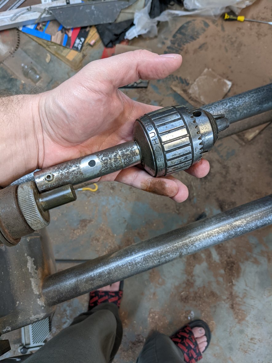

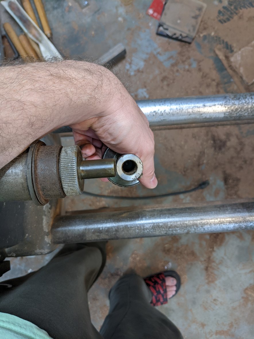

Hello, I have finally gotten around to getting my shopsmith running and have fun into a small problem. The drill Chuck that was with it doesn't seem to have a way to attach. From what I can find it doesn't look like this is the original chuck but at the same time it looks modified to fit it as well. I've attached a few pics to hopefully help figure out what I have to do. I'm fine with getting another off eBay of I need to, just wanted to make sure I wasn't missing something first. Thanks!
Re: Drill Chuck attachment help
You do not have an OEM chuck from SS. Yours is a higher quality chuck but unfortunately it does not have the 5/8" bore to attach it to the SS. I believe it has a "JT" (jacobs taper) bore. I do not know of any adapter that will fit.

That is a beefy chuck. Does that spindle/shaft unscrew from the chuck? Or is it one piece with the chuck. Almost looks like a chuck for an old blacksmith post drill press.

ShoptimusPrime wrote: Sun Jan 09, 2022 12:50 am That is a beefy chuck. Does that spindle/shaft unscrew from the chuck? Or is it one piece with the chuck. Almost looks like a chuck for an old blacksmith post drill press.
I have only tried separating by hand, not sure if it's screwed or press fit, it doesn't seem like it is one piece though. It looks like I'm going to have to get a new one, which is a shame because as you said, it's pretty beefy.

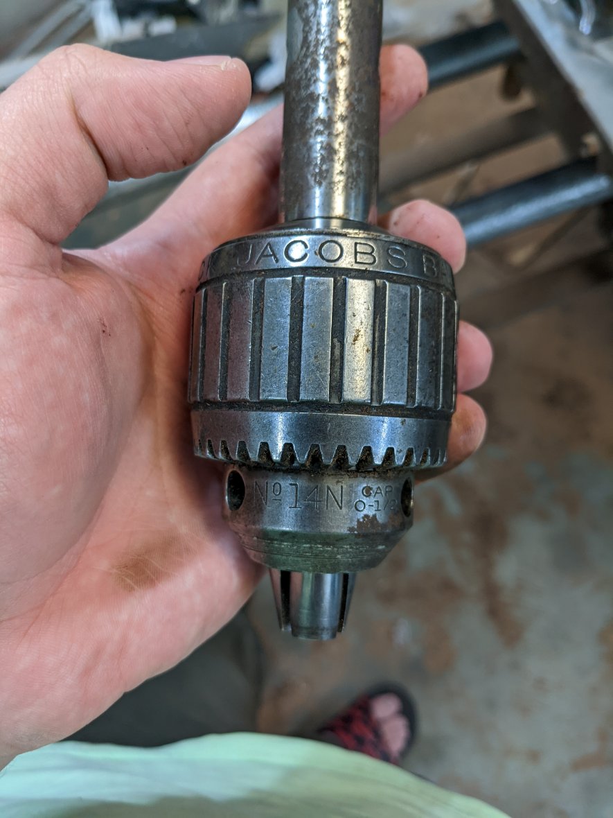

on the area where it says No 14N rotate it and it should be stamped as to the mount. For about $10.00 you can get a Jt by MT 2 taper and then use the chuck in your tailstock but as JPG said there are no know Jt to 5/8 adapters available.
Did a little research - it has a JT3 taper. The adapter is removed by fully opening the3 jaws and then nudging it out by tapping with a punch/dowel and a hammer.(or use a press)
So JT3 to MT2 male both ends.

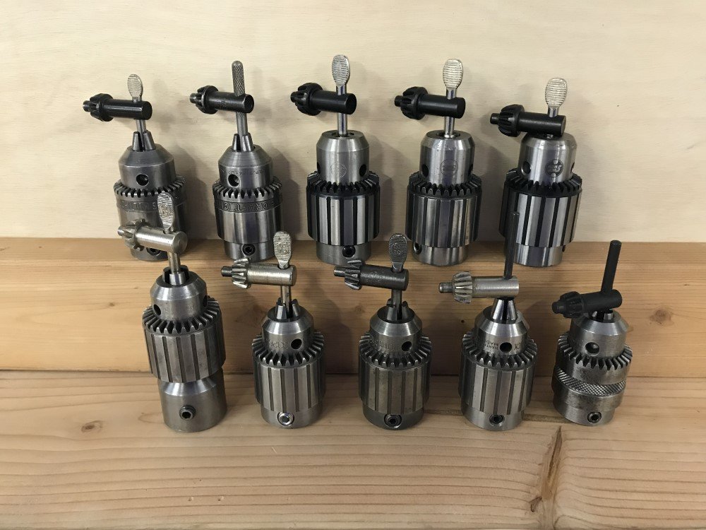

Since you now know what Drill Chuck you have below is a picture that shows the different Drill Chucks supplied with the Shopsmith through the years. Any Drill Chuck with a 5/8" bore will work and that includes non-Shopsmith chucks most of which use an adaptor.
_
Drill Chucks unlabeled.jpg (131.36 KiB) Viewed 10196 times
The above picture is unlabeled since yesterday I confirmed that my previous one was incorrect. Thanks, JPG, for the information.
The Drill Chuck on the bottom left is the original chuck assembly for the Shopsmith Model 10E from 1947. It is a Jacobs 33B Chuck on an adapter. That is followed by the three chucks in the middle of the bottom row the Jacobs 3326 Chuck. The difference on them is the set screw used. The Cushman Chuck on the bottom right replaced the Jacobs Multi-Craft Chucks which are the two on the top row to the left. The Jacobe Multi-Craft Chucks are different only in how the chucks are labeled. The three chucks on the top row from the middle to the right are the different versions of the current Drill Chuck Shopsmith sells. Again, the difference is how they are labeled and the one on the right is the current labeling. These are all 1/2" capacity chucks and use a key. All but the two on the left bottom row use a 5/32" Allen wrench for the set screw to lock them on the Shopsmith's spindle and have come with Mark series tools since the introduction of the Mark 5 in 1954. The other two (bottom row on the left) use a 3/16" Allen wrench and came with the Shopsmith Model 10E or 10ER.
Shopsmith also sells a 5/8" capacity keyless chuck. It can be found at the link below.
https://www.shopsmith.com/ownersite/cat ... _chuck.htm
Something to consider on which Drill Chuck to get is do you plan on using the Shopsmith Hollow Chisel Mortising System with your Shopsmith? The link below is given for reference. If so, it needs one of the regular 1/2" capacity Drill Chucks in the picture above except the original Jacobs 33B Chuck on the adapter. Longer Drill Chuck configurations will not work with the Mortise. That includes many of the non-Shopsmith Drill Chucks I have seen for sale.
https://www.shopsmith.com/ownersite/cat ... chisel.htm

Looking around the internet I see I can get a 5/8" shaft to JT3 taper, then get a 5/8" coupling and connect it up that way. (So it would be Spindle-->coupling-->5/8" to JT3 taper-->Drill Chuck)
As I'm not well versed in machinery safe practices, would this be an acceptable way to join it all up? Just wanted to make sure I'm not trying something dumb.
Posts: 4544
