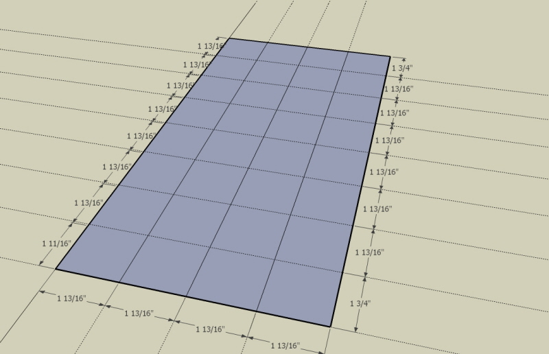

Possibly a picture will best convey my approach.
[ATTACH]2986[/ATTACH]
This sketch shows two approaches. One is more balanced than the other. I would use the one on the right side.
Pounding Board Drill Pattern.jpg (99.41 KiB) Viewed 5975 times
Where to drll the holes?
Another approach would be to trim the board to 7"x14" and then lay the holes out on a 1 3/4" grid. In other words perform a force fit.

Perfect Dusty, I agree the one on the right - even on each end.
Someday I'm going to learn how to do those drawing online.:o
