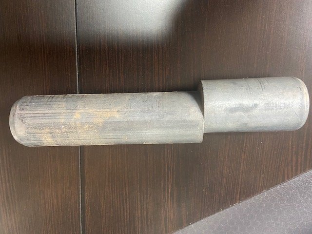

- the sole tube that came with my SS BS
- IMG_6236.jpg (57.3 KiB) Viewed 1463 times

OMG! They actually told you that? The part linked to in your post is different for another reason. They were created after the aluminum table was created and it was "discovered" during a demo that the original ones(might have been straight tubes at that time) would not allow with the wider aluminum table the SS to be tilted to vertical.
Since you have a cast iron table another one of the style you have will work. Older straight one as well.(sorta)
The jointer posts are MUCH shorter.
Ya need this un. Offset/eccentric - gets confusing!

As JPG has pointed out the standard eccentric tubes are different than the special offset ones you found. You can find the correct original eccentric tubes in the service parts under the Bandsaw. It is part number 5137779 Eccentric Post for Bandsaw and are $19.59 each. You should only need one if the one you have is a correct one. The Bandsaw Eccentric Mounting Tubes are 6-1/2” long and 4-1/2” from the top to the offset. The Eccentric Bandsaw tubes are the same as the Scroll Saw and Belt Sander. Note the Jointer eccentric tubes at 3-1/2" overall are much shorter than the Bandsaws tubes.
As stated in the description of the special offset Bandsaw Mounting Tubes in the catalog
Like JPG I cannot believe they told you it was new and improved instead of telling you about the standard eccentric tubes.
There has been discussion about using the Strip Sanders tubes which are 2-3/8" longer to have them go all the way through the upper ring in the Bandsaw's Main Fram Casting but they have to be cut shorter to fit.
This applies to Bandsaws with the aluminum table and fence so the Bandsaw can be left on the Mark V when it is raised into the Drill Press mode. This doesn't apply to Mark 7's or Mark V's with the double tilt ends. SPT's need to be removed before raising a double tilt end Mark tool.Designed to offset your bandsaw in the Mark V mounting tubes just enough to allow you to raise to drill press position without having to remove the bandsaw from its mount.

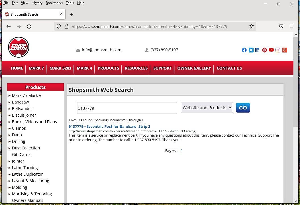

The SS site identifies the same part for BS and strip sander. ??

WHY all this talk about shortening Strip Sander tubes, when the SS site states the tubes are for both the BS and Strip Sander. ??? SS site funky ?
