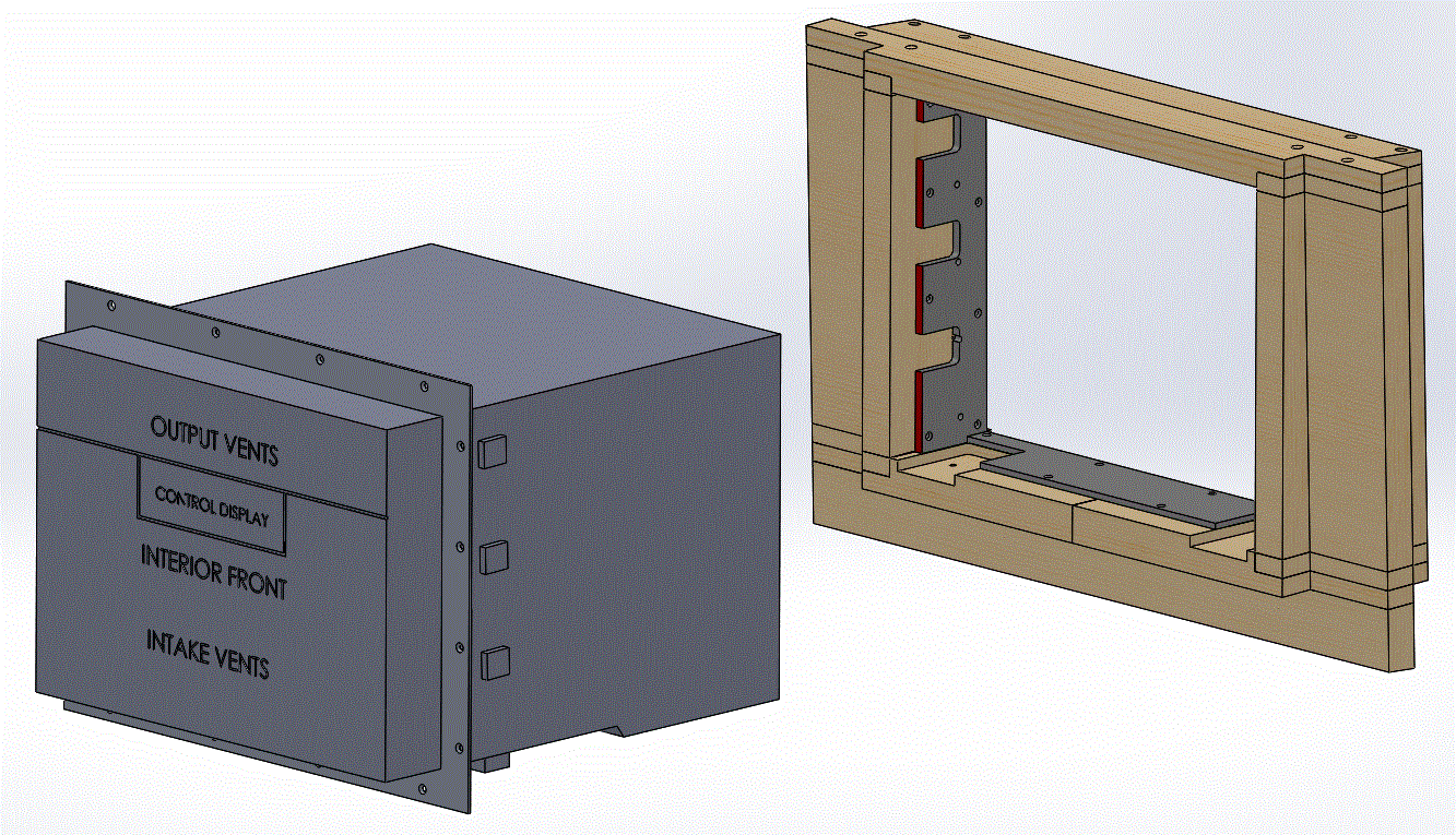

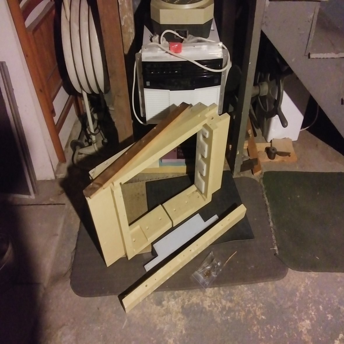

I note that you have a sliding window; what I have was designed for a wooden double-hung window but might be applicable to other window designs with modification.
Some years ago I designed and fabbed (with my Shopsmith of course) an AC holding frame. I was not satisfied with the flimsy manufacturer-supplied window-install components that typically come with the AC unit. AC units are heavy! I wanted something that would securely hold the AC unit in the window frame in the correct (5 degree tilt) orientation and be weather- and burglar-proof (kicking in the AC unit is a favorite way dirtbags break into houses where I live).
Images attached. The holding frame is in the basement now (for the winter), but I took a picture of it, and the AC unit.
I designed the holding frame in CAD. Had to model my existing window frame and also the AC unit. A lot of design work but it has paid off for me. Whatever you come up with, it needs to be able to bear the very heavy weight and overhung load that the AC unit will impose on your existing window frame. With modern crappy PVC window frames in use today, I am surprised that more AC units are not tumbling out of windows everywhere.

I like the interlocking design of your frame. Looks like it is well thought out. I've used window units in the past, but right now we're using a portable unit and the only part that goes into the window frame is one end of two large hoses, since I have the dual hose kit. Most portable units come with a single hose that exhausts hot air outside, but with a dual hose kit the air that is warmed up comes from outside instead of from the room that you're trying to cool down. I have room for both of these hoses to terminate on the plywood board and miss the frame, as I've already checked on that.
I did find a source for the spring bronze weatherstripping at a local ACE hardware, so I may give that a try. I also have to make up the difference between the thickness of the 3/4" plywood and the sliding window sash, which this will help with some. I haven't checked to see if I need to add more thickness to it beyond that or not. And yes, I do plan on using a good quality exterior paint in multiple coats on this board. The window is higher up on the wall under the overhang of the roof, so I'm not expecting any moisture on it other than condensation, which we get a lot of in the Houston area.

Nice . years ago we built frames with plywood fillers on one or each side and added a stop above the window, we never had a issue however your design looks much better .
Do you add a stop above the window so it doesn't slide up unwantedly ?
