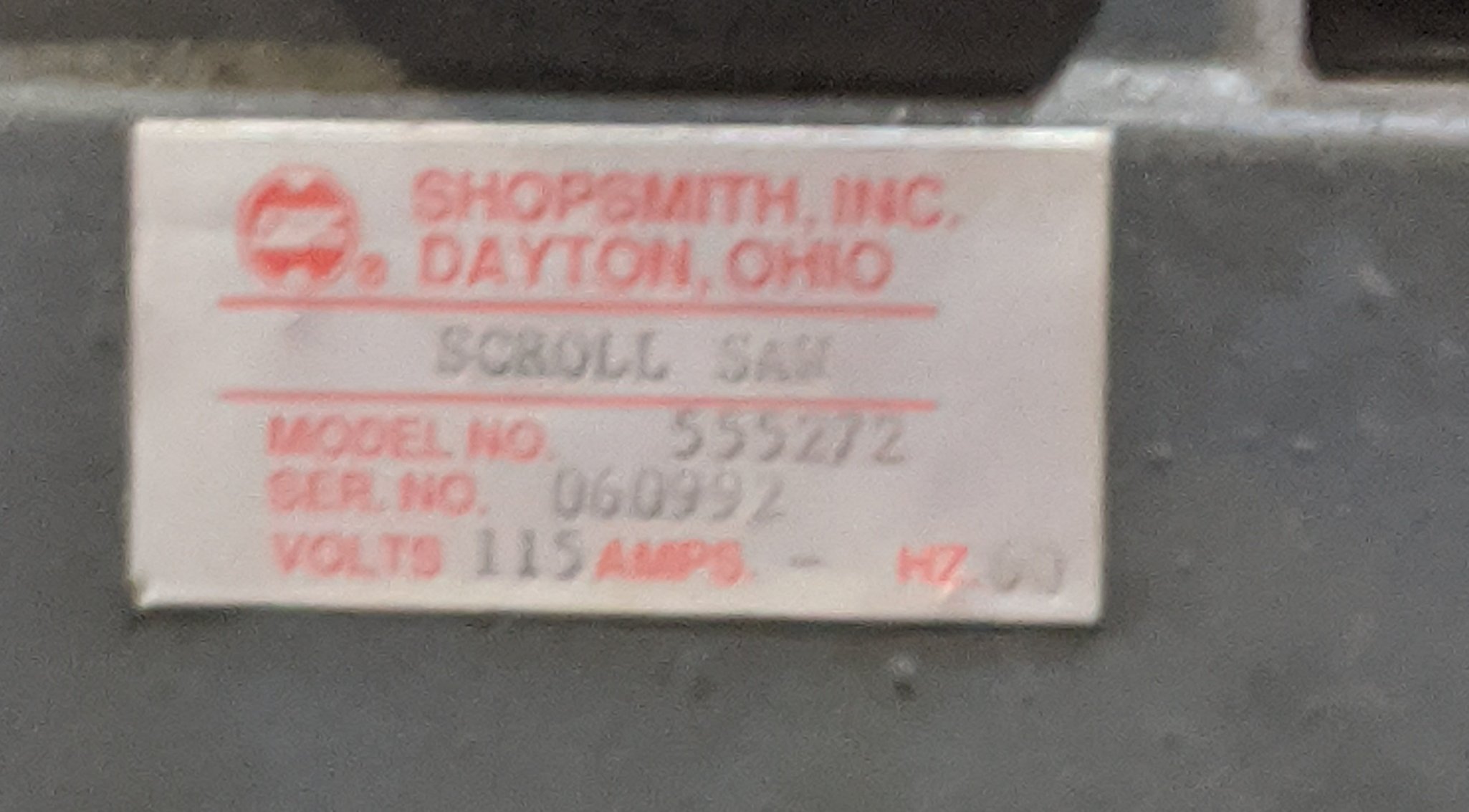

Picked up a free-standing scroll saw, date code 060992. That should be among the last units made before the Teal Blue version.

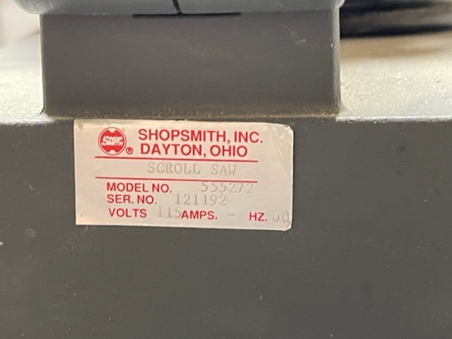

I just inherited the same model scroll saw (555272) along with a green painted Mark V from my father-in-law. The scroll saw is missing one of the Blade Clamps and the Mounting Block Assembly. The latter is no longer available from the Shop Smith. So I was glad to find this post. Ed from Rhode Island, did you order the upgrade kit and did it fit you 555272?
With the upgrade kit, is the Mounting Block Assembly still required?
Alan
Alan
Alan

Thanks for the replies Ed and Russ.
Ed, what reference literature did you order?
Russ, thanks for the information. The upgrade kits sounds like a much better route to go than trying to find the original parts. I like idea of the quick change. I think I'll go ahead and order it and get use to the idea of ordering upgrades from Shopsmith as I also inherited my father-in-laws ancient Mark V that needs some TLC.
If I read the serial number correctly, I think my scroll saw is a 1992 model, but looks the same as Ed's.
Alan
