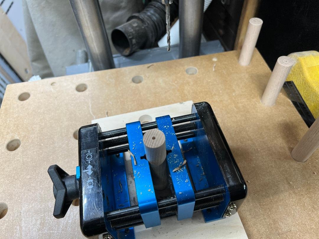

Not warm in the shop but I was excited about getting my drill fixture updated to fit the new clamps. Mission accomplished!
I don't recall if I showed building this or not??? Anyway while I was at it I took a couple of pictures which I will now share.
The fixture has a top with the 20mm holes and replaceable insert. The bottom is connected to the top with screws and dowels and the single larger dowel in the middle is not screwed in place.
The 4 dowels are all the same length and 20 mm in diameter. The center dowel is 1" and shorter since it doesn't penetrate top.
The actual length of the 20mm dowels was made 1" longer. The precise length is not important but having them all the same length is. I set up to stop to get them that way.
These dowels are hardwood so I needed to drill a pilot hole for the screw.
I put it back together and made sure the space was sufficient for the new clamps. It was.
Nice to have this done. Feels good to be back in the shop for at least a short while.
