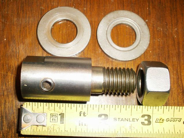

What Type of arbor is This?
This arbor was with a goldie. I assumed that it was used with a dado blade. When the adjustable dado is placed on the arbor, the burr goes on about halfway. The two washers were with the adjustable dado. I'm thinking that this is a 5/8" arbor for saw blades. .?. and should not be used with the adjustable dado? [ATTACH]3017[/ATTACH]
- 50620302.JPG (62.56 KiB) Viewed 6007 times
MK V 520; MK V 510 w/PP DIY Upgrade; MK 5 500; Jointer; Bandsaw; Sliding Table; Conical Sanding Disk; Sharpening Guide, Lathe Duplicator, Jigsaw, Scrollsaw, Beltsander, Ring Master, Biscuit Joiner.
- Posts: 35457
Whatzit arbor
Looks like a "12431" but is missing a washer that came with it. In 1963 it was called a 5/8" SAW arbor. It does NOT have a keyed washer/slot. Wasn't meant to be used with stack dado.allsas wrote:This arbor was with a goldie. I assumed that it was used with a dado blade. When the adjustable dado is placed on the arbor, the burr goes on about halfway. The two washers were with the adjustable dado. I'm thinking that this is a 5/8" arbor for saw blades. .?. and should not be used with the adjustable dado? [ATTACH]3017[/ATTACH]
