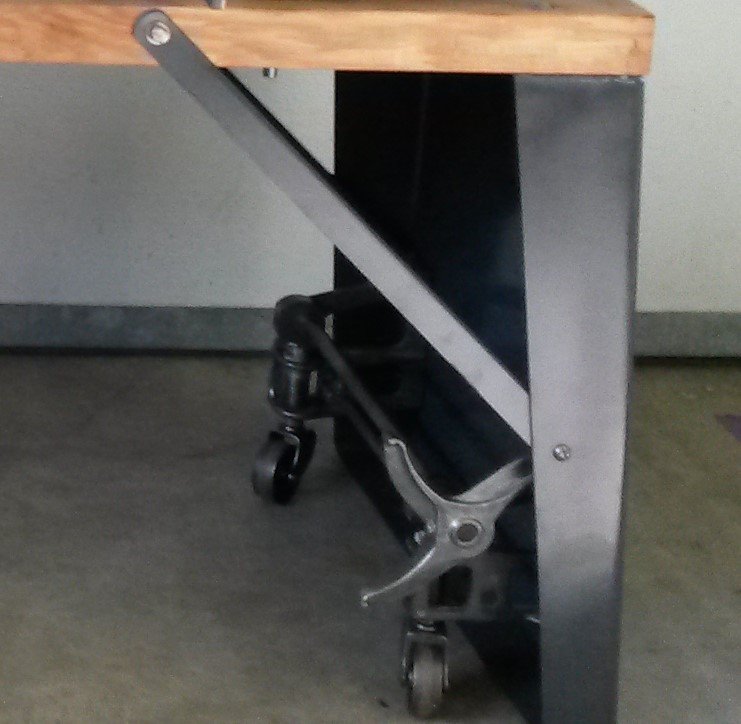

Scott had mentioned the change in the position of the Foot Pedal being moved away from the outward edge and the cam. Earlier Retractable Caster Assemblies with the Foot Pedal being closer to the cam will interfere with the 3" wheel upgrade. This is explained in the instructions and what to do about it.
I like the 3" wheels on my Mark 7 and have a set to put on my Mark V but just haven't gotten to it yet. When my Pro Planer and Power Stations need new wheels I will consider Scott's economy recommendation.
One thing Scott said that stuck with me was still having to lift his Mark V over extension cords after the 3" wheel upgrade. I would not try to roll a tool over an extension cord but instead move it out of the path. This is not only to make the movement of my tools easier but safer both for my back (Mark V's are heavy and Mark 7's are heaver) and to avoid damaging extension cords.
A little history on the Retractable Casters. They first came out by 1951 for the Model 10E or 10ER and could fit on both the Shopsmith Metal Bench Ends which Magna had already introduced or the legs of the Wood Bench from the plans Magna supplied with the Model 10's. They are shown in the picture below. The early wheels were metal not rubber. When the Mark 5 was introduced, Magna had re-engineered the Retractable Caster Assembly using some of the same parts (the Foot Pedal, Cams and 2" wheels). They have continued as an optional item since. The Mark 2 used a similar Retractable Caster Assembly as the Mark 5 but an inch shorter in the length of the rods.
_
Model 10 Retractable Casters.jpg (67.86 KiB) Viewed 4047 times

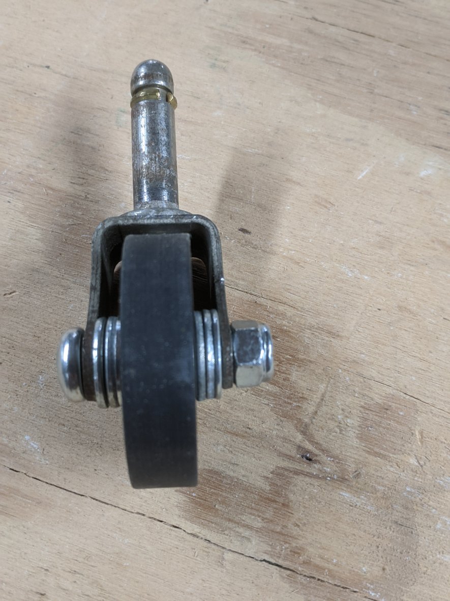

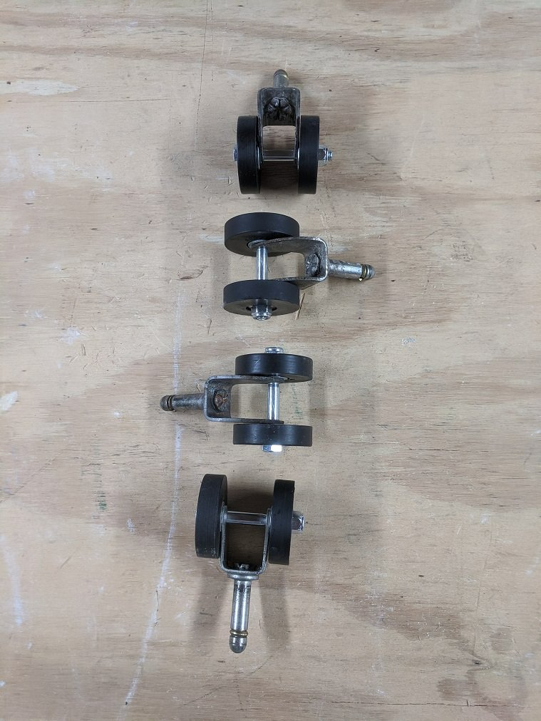

I am trying an alternative to the caster upgrade. Not that I knew of anything wrong with them, I planned on getting at least one set and maybe more, but I got curious about why they didn't offer a 2" caster with a ball bearing wheel. The standard casters are just hard plastic with a steel rod axle. They don't spin well with any load on them, the axle bearing surface wears down over time, the outer wheel surface gets scratched and gouged, dirt from the floor clogs the axle and gets stuck between the caster fork and the wheel. Most of us have seen the toll time takes on those simple casters. I posited that the major benefit of the upgraded casters was the ball bearing wheel. The wheels seemed to rotate fine on the stems already, it was the wheel rotation that was so balky. Obvious a larger wheel reduces rolling resistance and rolls over larger obstructions than a 2" wheel can, but replacing 2" wheels would be much simpler change.
I went looking for a 2" ball bearing caster replacement and I think found the reason Shopsmith didn't try that, it might be because they don't seem to exist with the proper stem configuration. But I did find a 2" ball bearing wheel. The wheels are $4.95 each from this place, or 10 for 29.95, a reasonable price I think.
That is just a wheel though. I figured I could use the casters with broken wheels I already have, cut the axles and wheels out, and use bolts to mount the new wheels. I found some load bearing info on the wheels but lost the link, it seemed reasonable, and since they were 1/2" wide I hoped I could mount two of them in each of the old caster forks. Unfortunately the old wheels are less than 1" wide and two of the new ones would rub on the caster forks. I tried reshaping one but it didn't turn out that well, I'd have to cut some pieces of steel to use to reshape the forks correctly, and I didn't feel like getting into that. So after fooling around a little with two wheels mounted outboard on the fork I just used a bunch of washers to mount a single wheel centered in each fork.
The results? Well it works. It seems to roll with less effort than brand new casters, it changes direction much more readily, and the softer wheel material rolls more easily over obstructions. I haven't had these mounted up for very long, so no way to tell how they'll hold up over time. If they don't fall apart quickly I'm sure I'd do this in the future instead of replacing any more 2" casters. I still may try one of the 3" upgrades, at least for comparison. Enormous pictures follow:
ETA: Just remembered I got the load information by looking up the bearing number.
ETA2: Static Load Bearing 310 lb - Dynamic Load Bearing 740 lb. One wheel per caster should do fine

Nice option Ed. I have to ask about the washers used as spacers. With them being that large of a diameter do they still only touch the inner shaft of the bearing? This is a nice option especially for those, like yourself, that have older Retractable Caster Sets with the Foot Peddle closer to the cam.

chapmanruss wrote: Fri Apr 08, 2022 12:34 pm Nice option Ed. I have to ask about the washers used as spacers. With them being that large of a diameter do they still only touch the inner shaft of the bearing? This is a nice option especially for those, like yourself, that have older Retractable Caster Sets with the Foot Peddle closer to the cam.
I had a pile of those washers, just the right size. They have a 5/16" hole but I believe they were sold as 1/4" washers. Only one has to be up against the bearing to clear the wheel, I could have used other washers for the rest but those were handy. It would be easy to make a spacer from all sorts of material, I have some 5/16" ID DOM tube I could use to do more of these. Before I go any further on this I have to see how these wheels hold up over time.
I first tried using two wheels, one mounted on the outside of each fork arm with a bolt all the way through. A third wheel could have been mounted in the middle. But it was easy to see the problem of having the wheels mounted so far away from the stem axis when turning. The wheel set wouldn't change direction as easily and it was clear the wheels would scrape to change their position.
Now that I have the load data again I'm pretty sure that just 4 of those wheels, one in each caster can handle the weight of a Shopsmith. I'm not sure how much help small wheels like that will be if you have to roll across a very rough surface, but they seem good enough for my basement floor.
