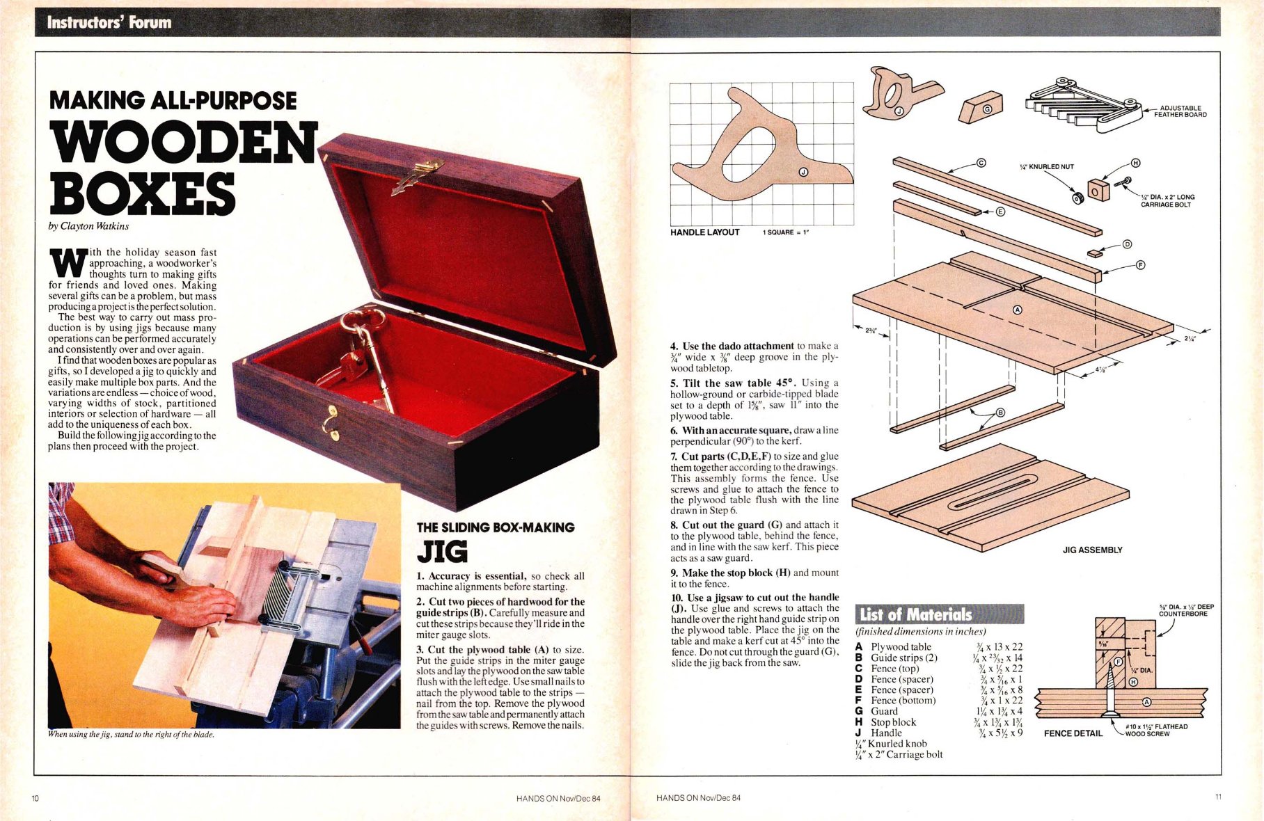

My curiosity was piqued, so I dug out my old copy of the Hands On issue to see what it looked like. I may have to try and make one now.
sliding box making jig 2700 x 1754.jpg (420.28 KiB) Viewed 4284 times
P.S. Try as I might, I can't seem to find a good resolution for viewability and be within the size limitations. If anyone would like a higher resolution version (pdf or jpg), just send me a PM with your email address.

I always have one of my miter gauges set up as a small crosscut sled using 1/4” paneling or Masonite for the bottom. Seems like this would be easier keep square than getting the fence square to the runners on the jig shown above.

That particular sled is not for me, but I could see leveraging the basic idea (which is a cross cut sled) into something I'd like. As a generalization, I prefer taking cuts all the way through past the outfeed end of the blade. This one seems to be intended for either backing out of the cut or stopping the sled and the saw.(?)
