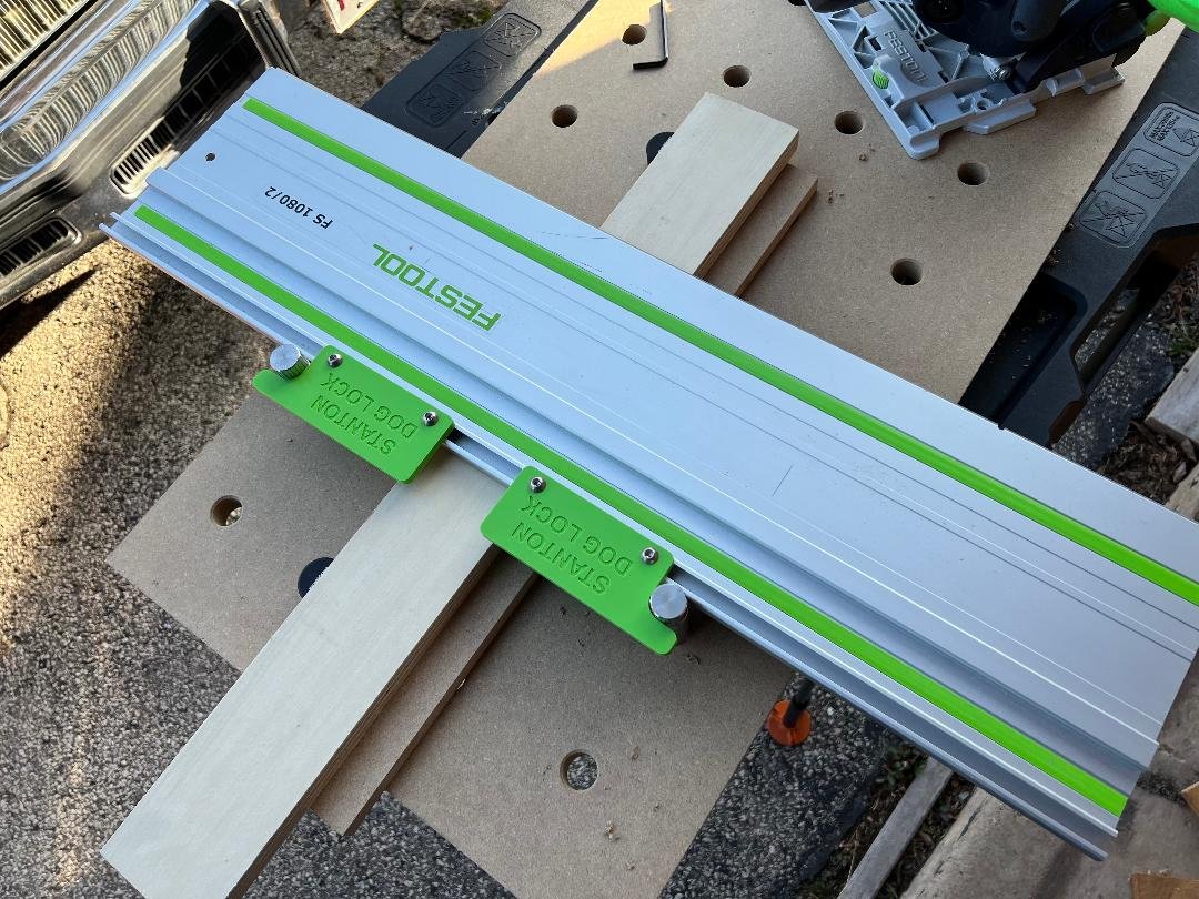

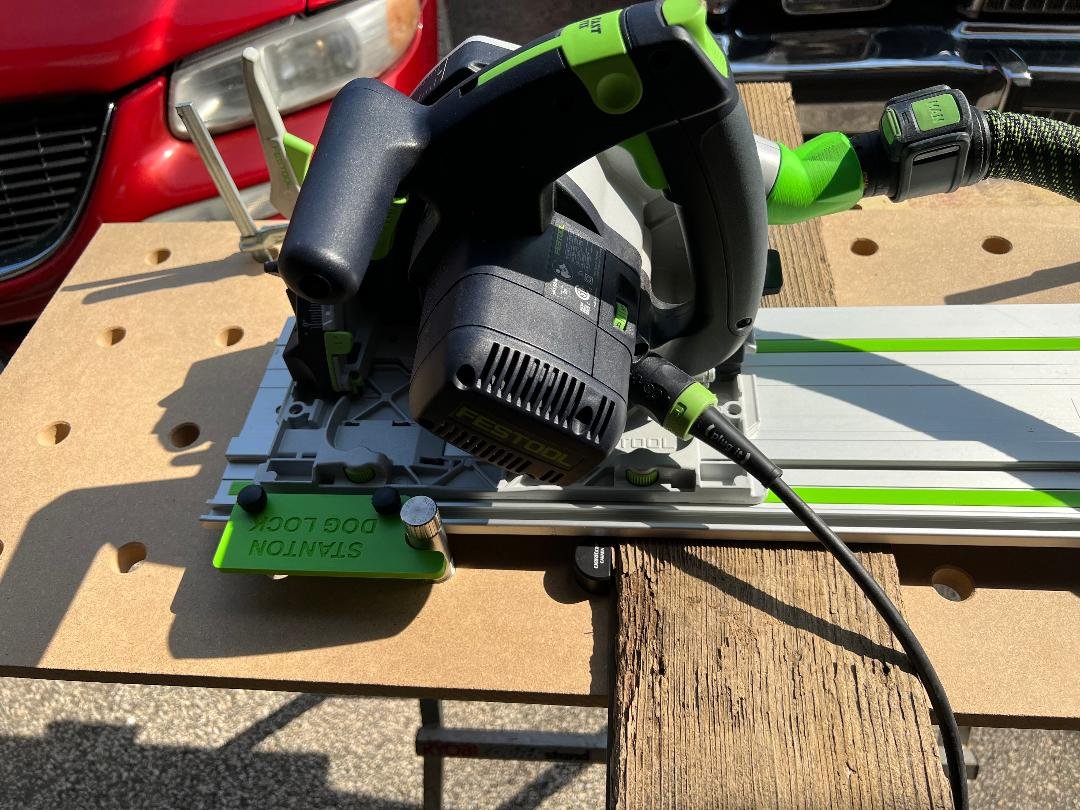

My parts arrived and I got to do a set up today to see how they worked. I have a different set up then Dave shows but is something that I'm presently looking at for some cuts I want to make. This is and Dave's setup are not the only ones that can be done by any means. In my case I have a narrow top and was looking at doing some cross cutting across the narrow way. This is almost to short for what I need but I went ahead looking at the setup anyway.

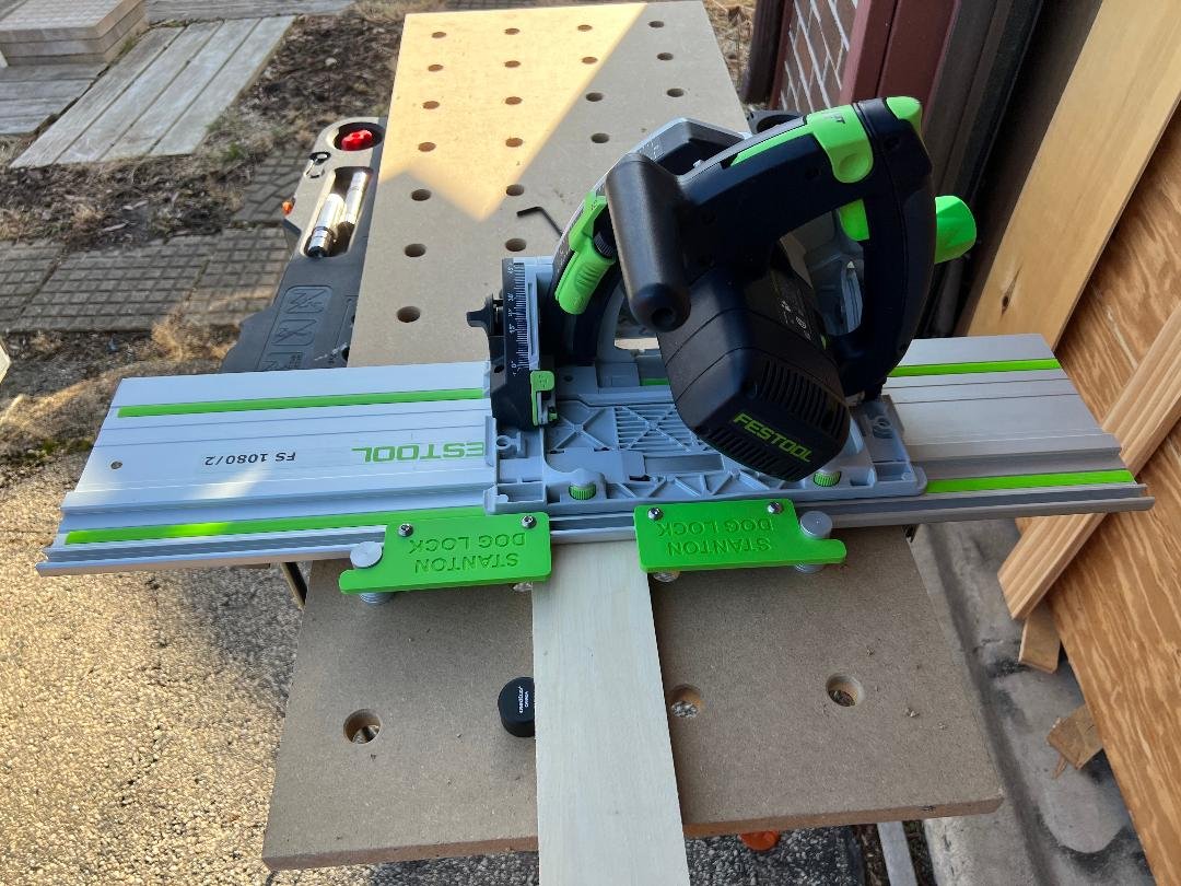

If you have watched the video you see how the dog locks work. They can be used as a pair as I have done here:

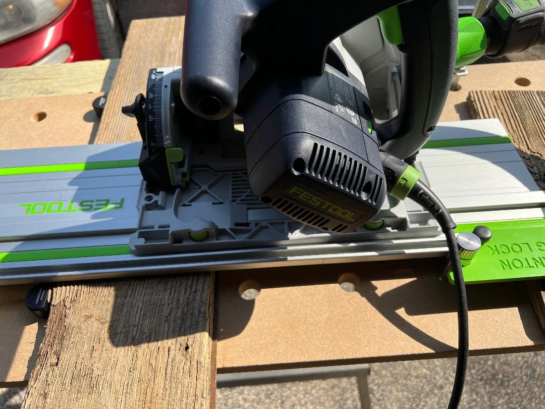

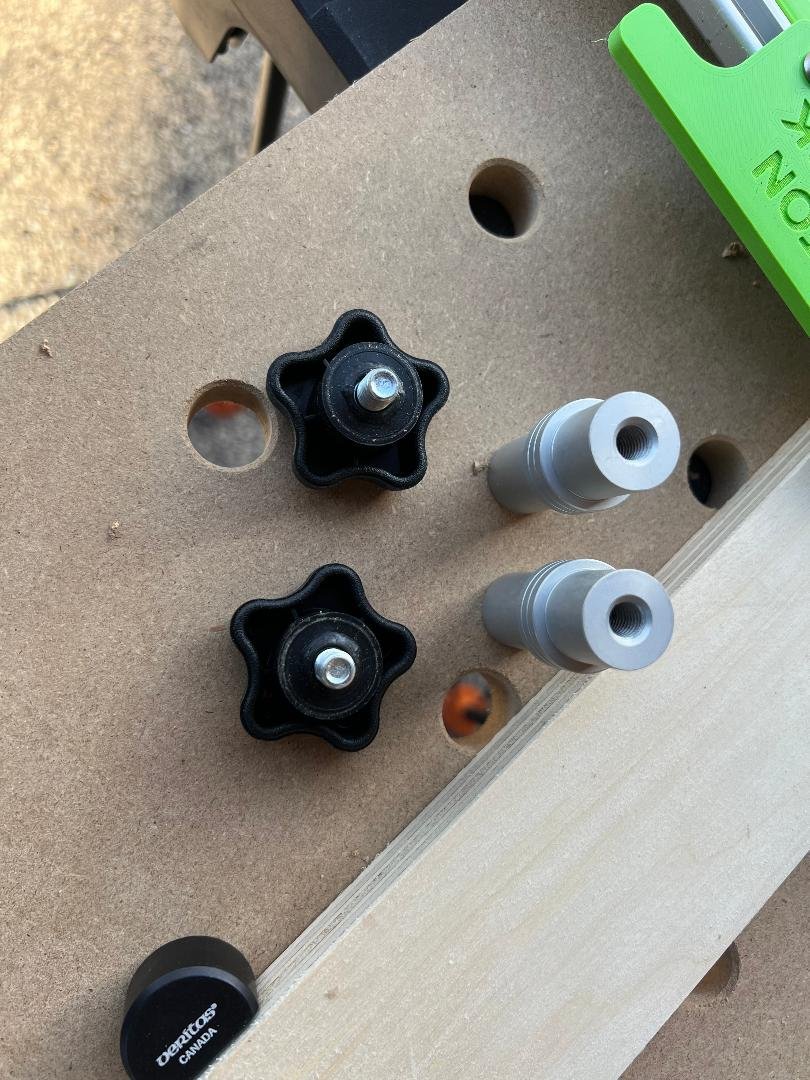

I have a collection of dogs and these are the mid-sized ones. I have shorter which will not work at all and taller which then start to potentially cause possible interference. Easy work around are yet another topic. The dogs shown have a threaded hole so a knob can be added below the table to secure the dog and to stabilize them, they are required for use in this case. This next pictures shows the underside of the dogs and the knobs.
There is another style of dog that uses a chamfer and o-rings with a top thread that can be placed from the top of the table. The ones I have a taller and would limit the depth of cut located as they are.

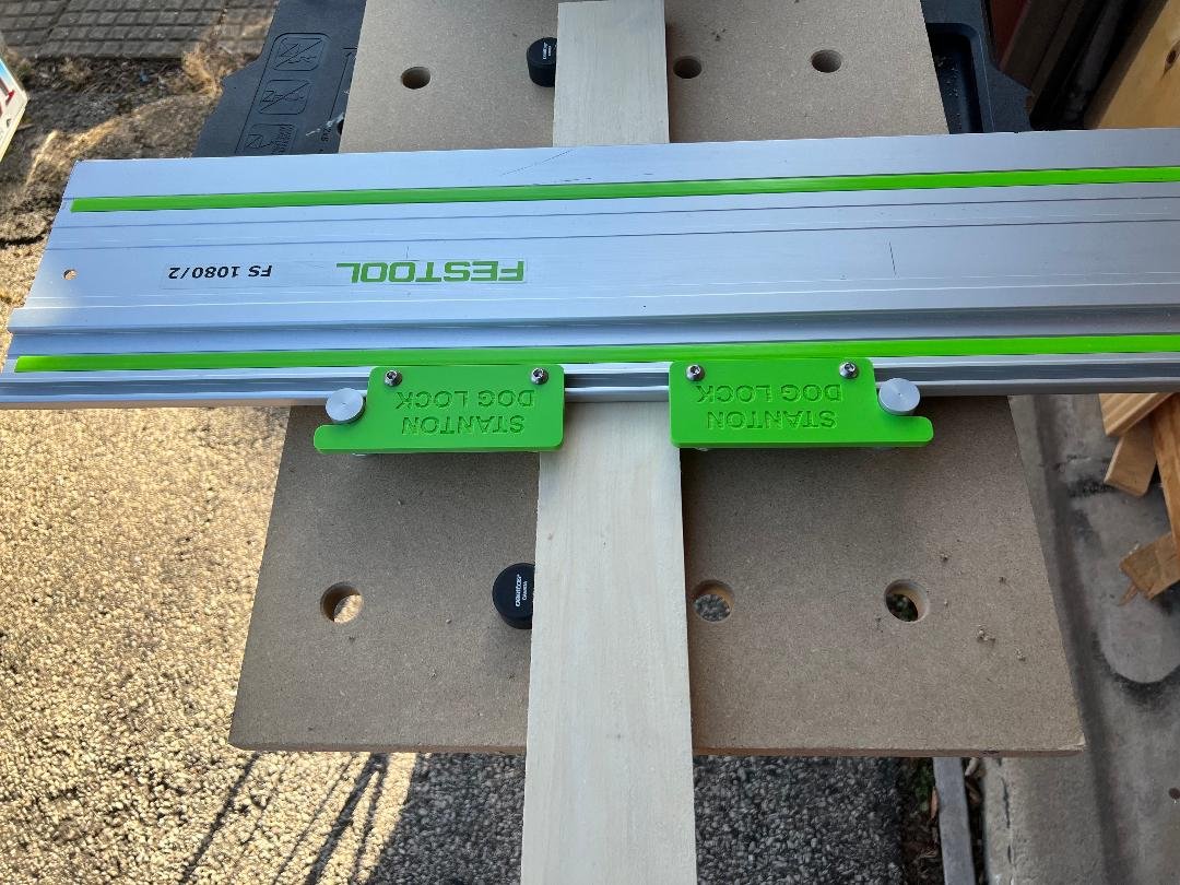

If the dogs can be placed farther away from the cut then this is no issue. How ever in this case a simple solution would be to add some waste board under and this effectively places the work piece higher on the dogs. As seen here:
I was a little unsure how well this idea would work but now I'm convinced it works fine. My idea of a narrow location however doesn't look like it will make the cut...... It would work but would confine the width too much for general use.

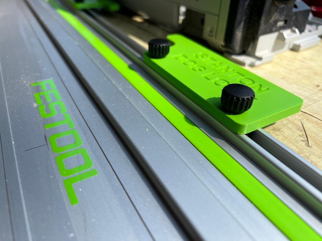

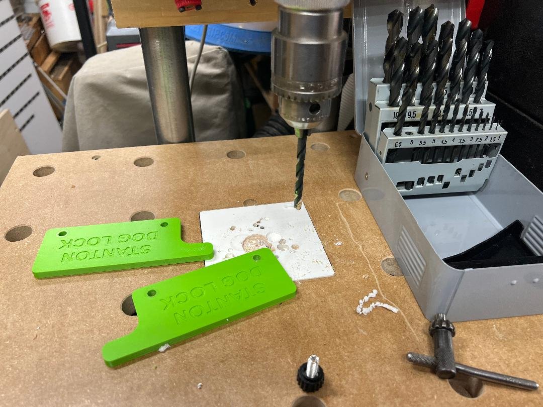

I started my day by finding some knobs, M6 x 12 I think. If someone needs the details I can look up my order history on Amazon. I seem to recall paying about $10 for a bag of maybe 10??
The holes were slightly undersized for the M6 hardware so I took them to the shopsmith and drilled with a 6mm bit. Perfect!
The knobs really do make adjustment much easier and faster. These knobs could have been a little shorter in the knob area, they limit cutting depth to 1-1/2". If I need to cut deeper I can put the screws back in I guess but that is deeper then I normal cut.

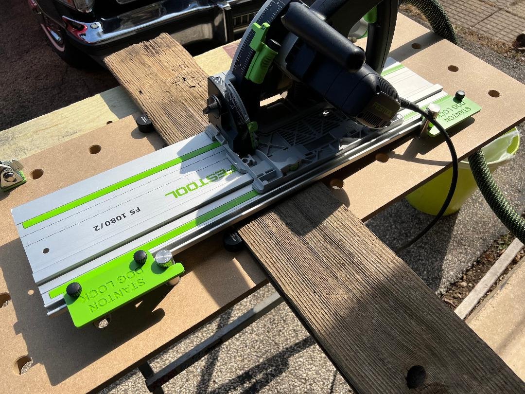

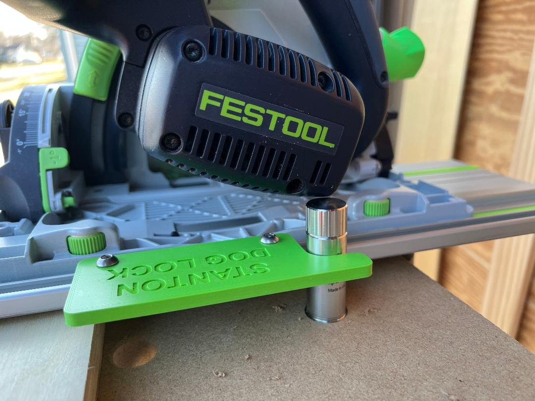

I'm not sure if yesterdays post made it clear how you can stay out of the way of the dogs. I have the tall dogs installed and in this photo you can see the saw is past the dogs for the start of the cut.
When the cut is finished you still have not reached the other dog as shown here:
I actually did some cutting today and am well pleased with how things are working.
