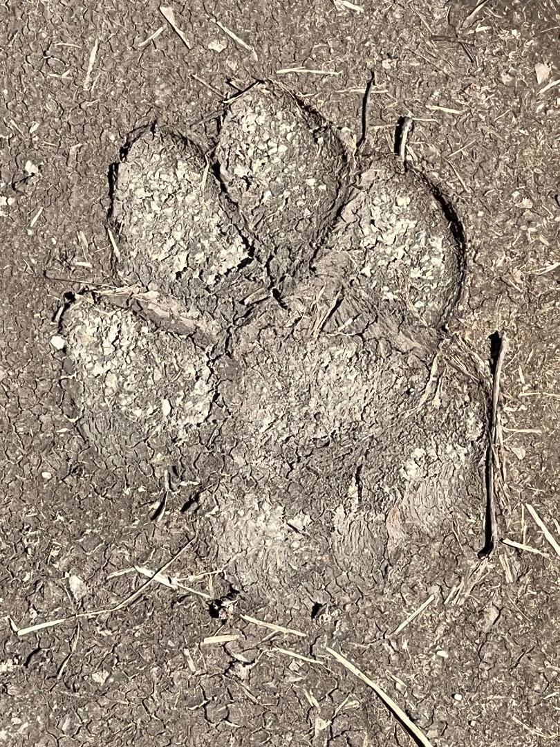

I have an idea that I would like to add to an outdoor bench. It would be dog prints on the seat, as if a dog had walked on it with muddy feet.
This is an actual muddy print I photographed the other day:
dog print.jpg (451.06 KiB) Viewed 4294 times
I would make it mostly a stylized version with primary pads and nothing else.
I can think of several ways to do this but what I think I'm interested in would be to do an inlay with epoxy. I have the necessary tools to do the inlay but have never tried the epoxy portion. Gut feeling says it has to be level with the surface so water doesn't set in it. Like wise being outdoors I wonder if the inlay epoxy with want to pop out since it doesn't move at the same rate as wood. Likewise separation at interface could/would allow water to get between things which is undesirable. I guess a epoxy finish over the whole seat might solve that?
Another thought would be to do a wood inlay. A lot more work and you still might have similar issues to the epoxy.
A third though would be to make a dog print stamp and use that. In fact it might be something one could buy, but I have never seen one large enough.
A forth option would be a stencil and paint or even hand painting??
Anyone ever done something like this? Ideas and thoughts??
