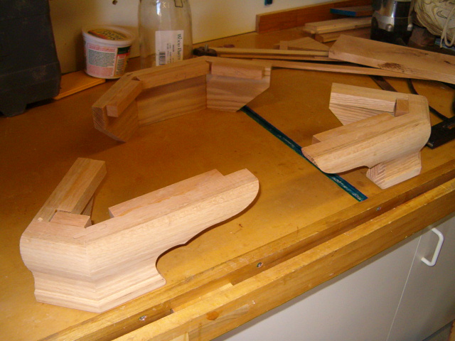

- HPIM0961.jpg (131.89 KiB) Viewed 21436 times
- a1gutterman
- Posts: 3653
Nice feet charlese! Quit teasing us and show us the rest of the ??? that those feet go to!charlese wrote:...My feeling is you can't go wrong with a good RAS. It'll cross, miter, rip, dado and even make large curved grooves for moldings and feet like pictured. Although these feet were made on the Mark V.
Tim

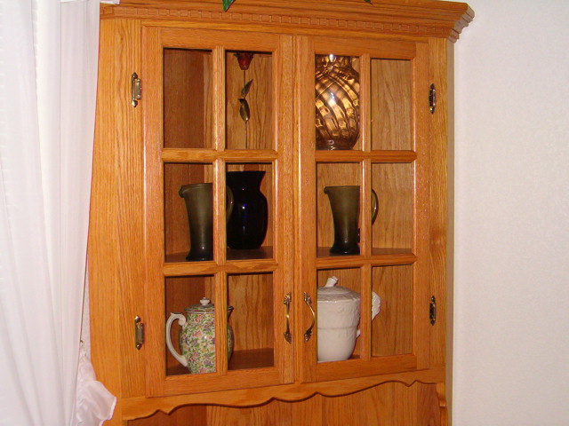

I did! They are from the corner cabinet from last year. Here's the top of it, but I still can't get the total piece to fit the format for this forum, without rotating it.
- HPIM1505.jpg (101.84 KiB) Viewed 21411 times
