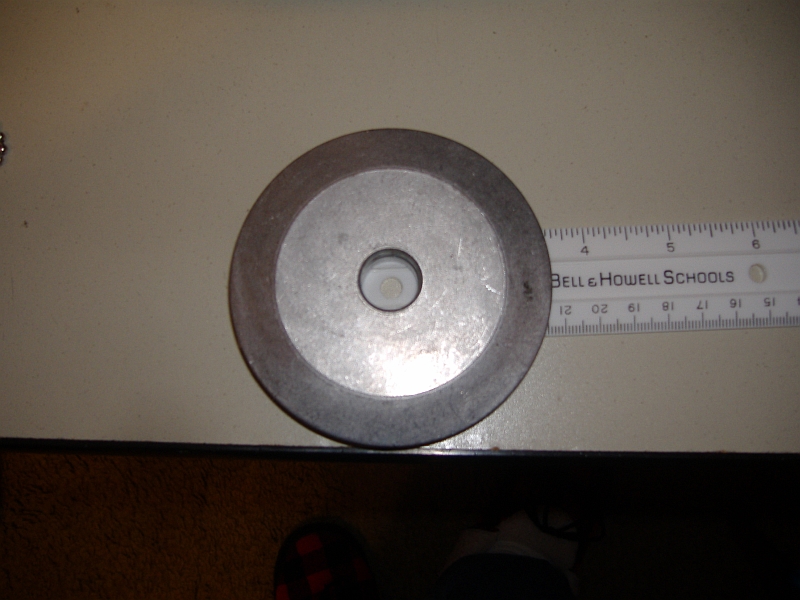

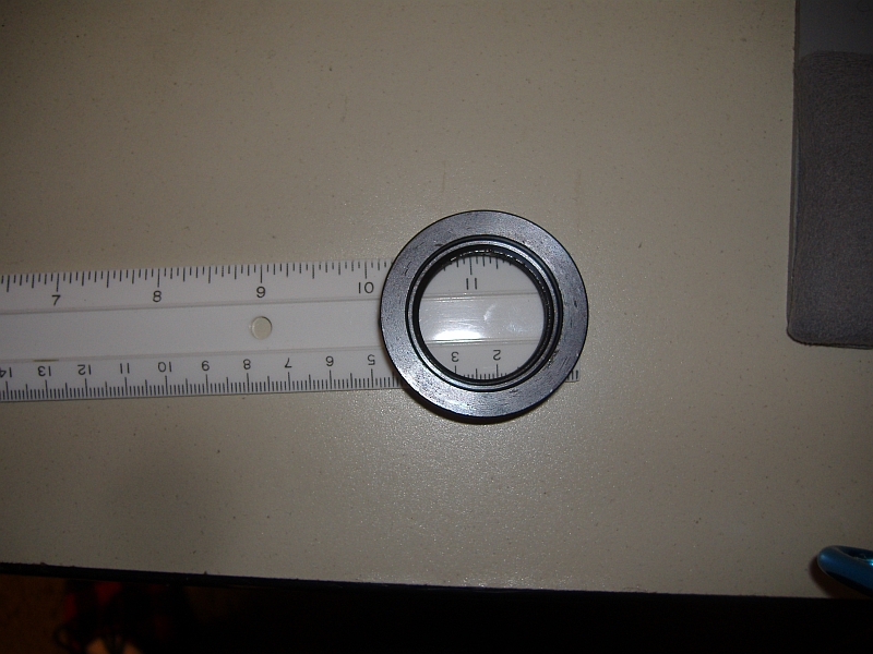

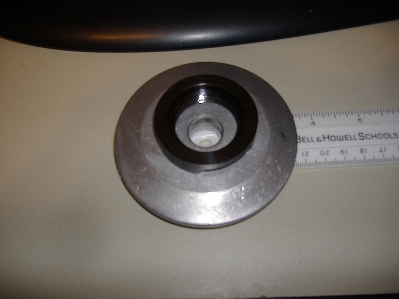

Now for a few pictures. First is one next to a rule, as you can see it is about 3-1/2". On the other end of the ring is the shopsmith saw arbor coming in at 1-7/8". Then a shot to show the relative differences in size between the two.

Keep in mind the stiffener pictured is 3-1/2", not the 5" which might be the recommended size... and other options like 6" or even 7" are sometimes used.
What I haven't done is attemp to mount the stiffeners and a blade on my shopsmith since I've upgraded to the 520. I have no idea if the spacing can be adjusted for alignment so these may not even work anymore. I might give it a try once it warms up again... now that I have gotten them out.
I you choose to look into this more keep the spacing issue in mind. The ones shown are many years old and I have not been tracking the trends or developments of them... I'm sure they have made improvements and revised guide lines several time...
