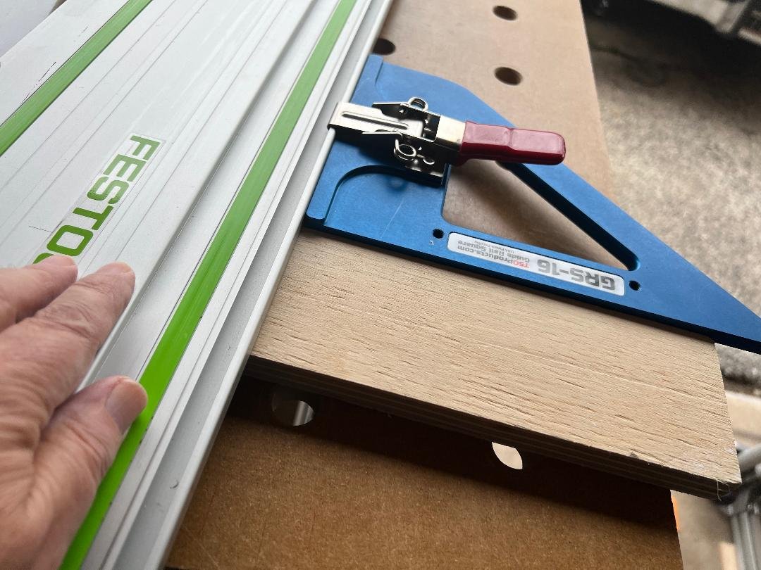

If you use rail squares you might have noticed that sometimes the square due to it weight tip something like this:
You can of course put some weight, like your hand or the saw to get it flat again:

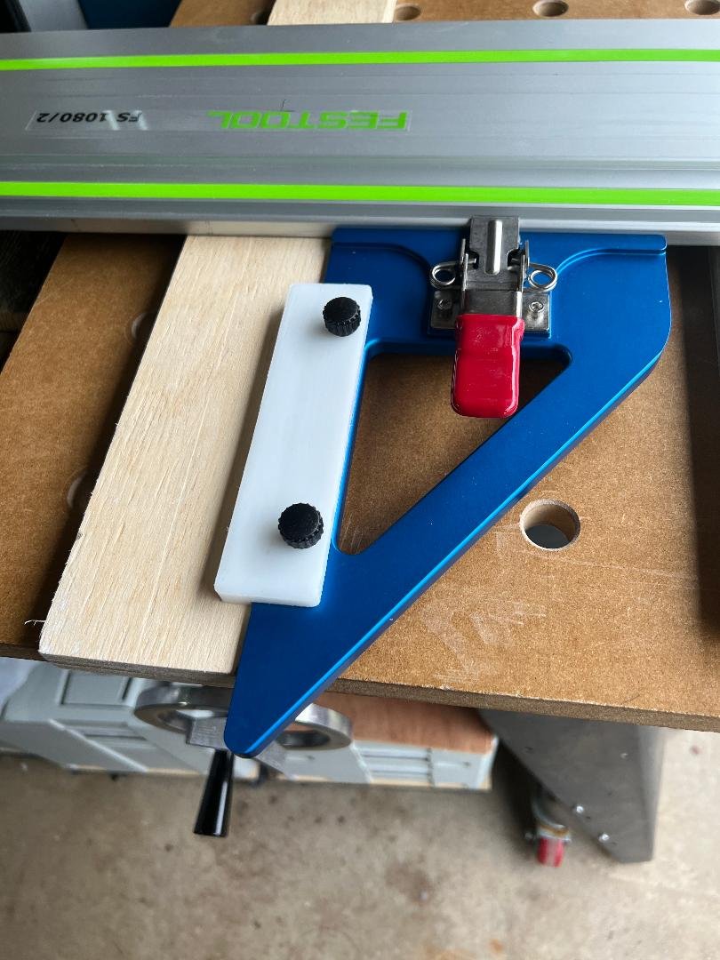

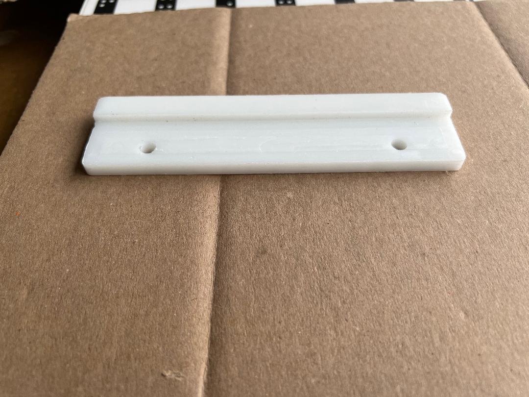

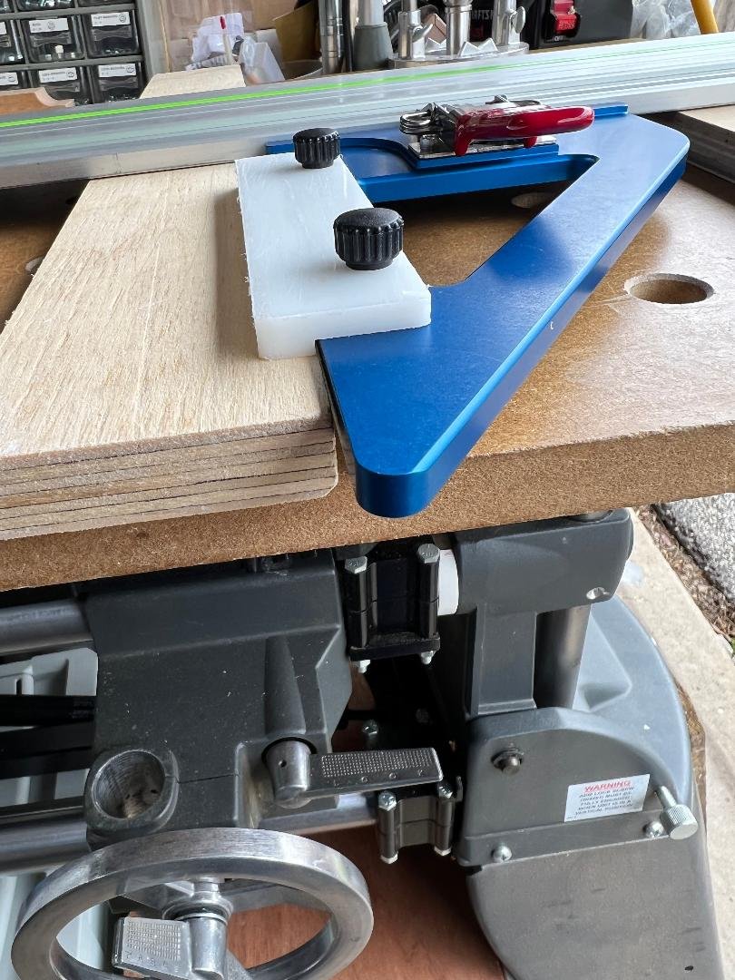

I have various scraps of plastic around so that is what I chose for this build. And as you can see which other options I went with:
Once mounted it looks like this:

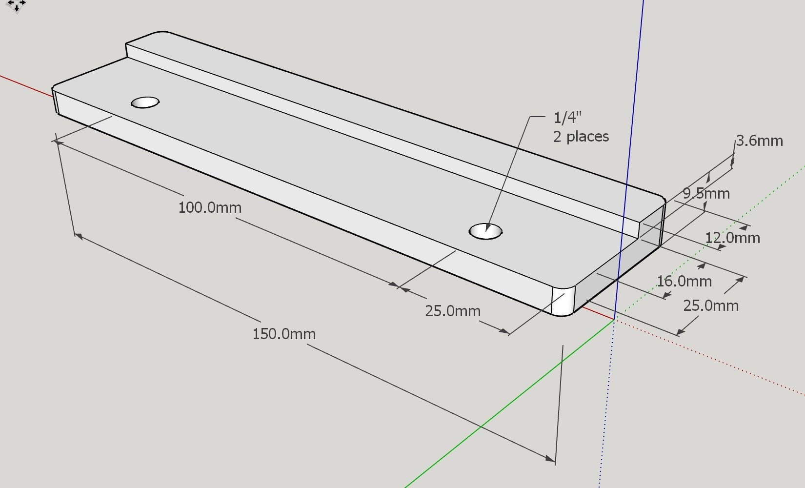

As I use it more I may make a few changes or well not. This is a drawing that gives pretty much what I made:
anti tip grs16.jpg (119.55 KiB) Viewed 1286 times

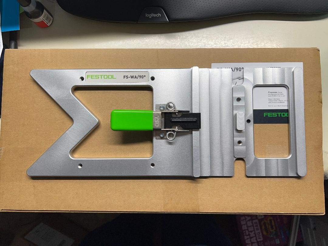

Unboxed:

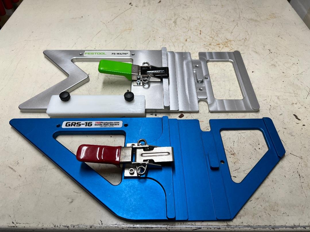

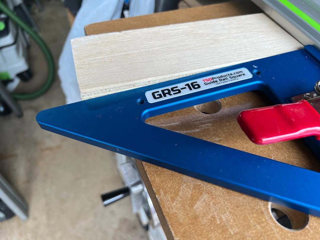

And yes the hole pattern is the same:
Now I can produce a couple more and try a variation or two.
Re: Today in the shop "Anti tip for GRS-16"
A little heads up here. The TSO version has an extra set of hole to allow it to mount to a MFT hinge. The festool version can be updated with information from TSO if that is something you want to use. I don't think I need that function but got the drawing from TSO anyway so if I change my mind I already have it.
