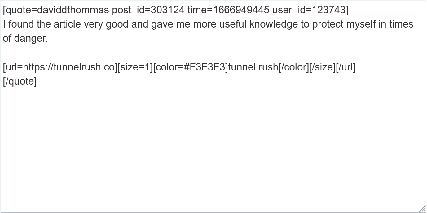

No need to stand by, it is already there. One of those links you can't see until you open the post in the editor.
Reported
- Screenshot 2022-10-28 at 19-48-07 (5) Shopsmith Forums - Post a reply.png (53.44 KiB) Viewed 1114 times
