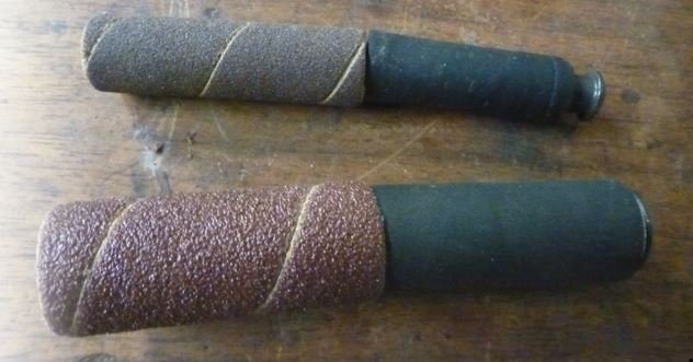

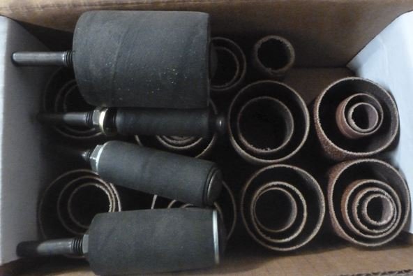

Before I do something I may regret. I know some of you have dealt with this. Yesterday I bought a bunch of extra long drums and sleeves (stocking label was dot-matrix. Box label appears to be earlier Bighorn. Two had been stored with the drums highly compressed on the sleeves which I cut off. Pictures show ends compressed. I can't install new ones and could just chuck them in the SS and sand the ends down. Is there a better way to restore these to previous shape?

I coat the drums with talcum powder, so they slip on/off easily. Are the nuts fully loosened?
Re: Sanding Drums Question

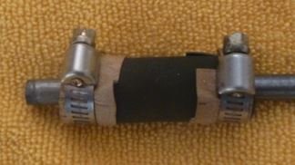

Are you saying the drums are distorted so the sleeves will not fit on them? Looks like the drums are the type expanded by tightening a nut on the shaft. If loosened an old expanded drum may not return to it's original shape. If they're not too bad you may be able to restore them by wrapping a piece of cardboard around the drum for protection and tightening band clamps on it for a while. Sometimes just a little bit of the drum protrudes from the sleeve and forms a ridge new sleeves can't slide over. If a band clamp won't squeeze it down then sand or file it enough so sleeves will fit.

Ed, you suggestion may work. They were tightened so much the ends are expanded. I'll try the clamp and if that doesn't work just sand off the ends a bit. I also like the suggestion of using talcum powder before putting new ones on. Thanks guys.

I had a couple like that, but not as severe. I put removed the hardware, and put them in hot water (hot tap water not heated on the stove or microwave) for about 20 minutes and then rolled them on the counter under the palm of my had for a few minutes. The looked like new.

This is using Ed's 1st suggestion. Since the drums were on a spindle that is threaded through I inserted a rod so as not to compress anything into the threads creating another problem where I couldn't get them off. I'll leave them like this for a few weeks. Chris' idea of hot water might also help. What are your thoughts about putting them in how water while clamped?
