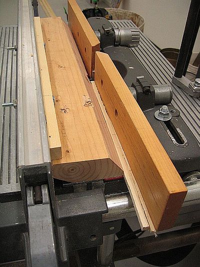

We've been working on building our new house for the last couple years, and have finally reached the fun part: finish trim. Installed Tongue and Groove ceiling in the great room, and brought the T&G down the front wall of the living room, around the windows. After I trimmed out all the windows, needed an appropriate casing to frame them, but couldn't find anything I liked. So, we ripped a bunch of #2 or Better 2x6x10s into 3/8 x 1-1/2" strips (planing the good edge before ripping) then ran them thru the SS Router/Speed Increaser set-up to give us a 30-something degree bevel to match that of the T&G.
To accomplish this, I milled a 2x4 with an appropriately-angled face (60-some degrees?) which would guide the molding strips into the 1/4" straight router bit, yielding the correct bevel angle on the molding. You can see this set-up in attached Router1.jpg. The Shaper fence had to be adjusted to take up the space, after the bit, where the bevel was cut. (you can see my Shaper Fence is the old model, modified to fit my 510 table) The shims before the bit are to keep the molding from sliding down, which makes the bevel too deep.

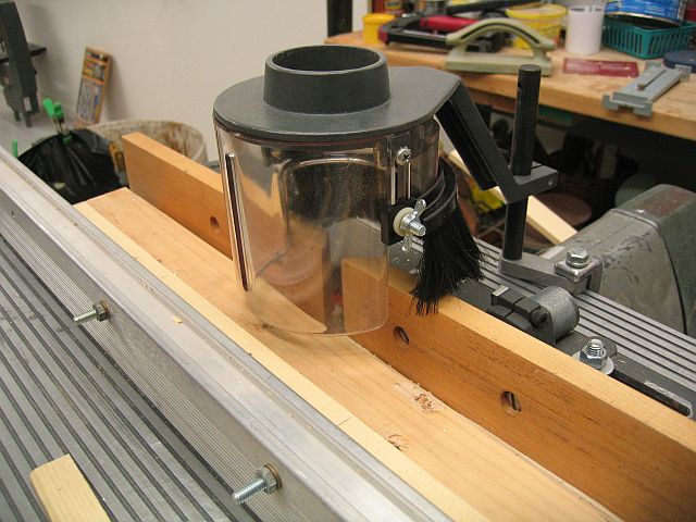

The second picture shows the guard attached. The vacuum hose, when affixed, sucked up any small dust, but left the larger chips to fall on the floor (couldn't lower the guard any further, as it would get in the way of the molding passing the router bit).
Thanks to the Speed Increaser, we were able to mill about 350 linear feet of casing in about half an hour. Granted this is pine, not hardwood, but it sure worked fine!
