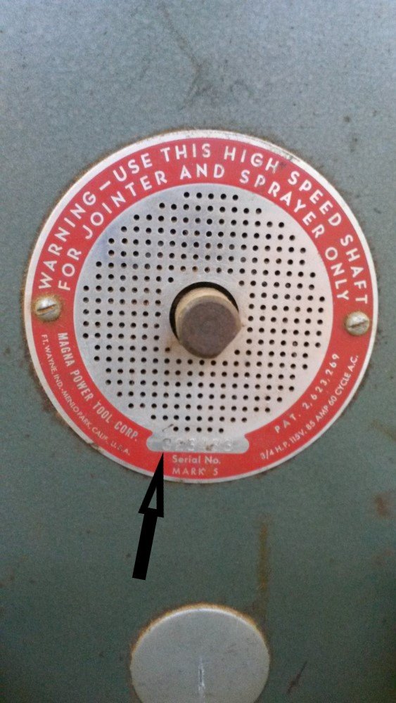

First, welcome to the forum. You should find the Serial Number on the vent plate on the left side of the headstock. The vent plate surrounds the lower of the two spindles on that end. That is a fine looking Greenie. Looks like original paint. It is from the 50's. I have a similar model, and yours is in better shape than mine was when I got it in the 80's. Excellent condition for its age.

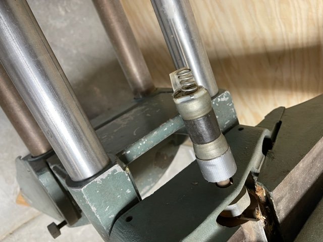

Very nice looking. And look at that coupler on the joiner! Is that like the top one in this picture with setscrews? viewtopic.php?p=296205#p296205
Maybe not, hard to tell when the picture is enlarged.

As David said you can find the serial number on the bottom of the plate that looks like the one below.
_
Serial Number Location.jpg (113.91 KiB) Viewed 10309 times
The serial number will tell us when it was made and help in giving advice. There have been many changes made to the Mark 5/V over the years but the good news is even the oldest Mark 5 can be upgraded or use current replacement parts. Many have had parts replaced. Sometimes they can use individual parts while other times you have to replace assemblies. More on that as we go.

The Jointer has a power coupler on the drive shaft but is broken on the Mark 5 side. Not surprising since that coupler is from the 1950's. It is the second one from the picture ED linked to.

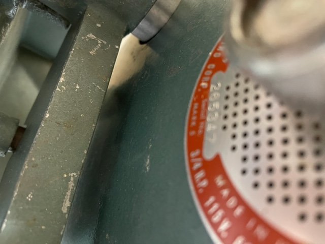

Not sure I would have ever found that serial number without your help. It is serial # 565347.

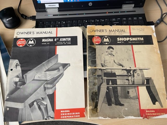

I also found a note on front of the manual in my father-in-law's handwriting listing the serial #565347 and "1954". So I guess I have a "Magna Mark 5" as opposed to a "Shopsmith Mark V".

Here is a close up picture of the jointer coupler. I don't recognize it in the pictures that Ed linked to.
It appears to be broken and duct taped together. I don't see the coupler listed in the parts diagram for the jointer. After seeing the close up picture, can you identify which coupler is the correct replacement part? BTW--The jointer is a Magna 4" Model 620.
I do have what appears to be the original manuals for the "Mark 5" and the MAGNA Jointer and a hardcover book entitled "POWER TOOL WOODWORKING FOR EVERYONE" by R. J. De Cristoford.. Shades of Ward Clever or Fred McMurry, I guess I need to get a pipe if I am going to use the Shopsmith and change my vocabulary: Me and forum spelling checker thought it was a "JOINER" as opposed to a "JOINTER" ;-)

Below is a picture of everything that I found in my father-in-law's shop that I thought was associated with the Mark 5. I didn't find any type blade guard, riving knife or dust collection port. Perhaps they didn't have those in 1954? Is there any item missing that I should have?

Do you have arbor wrenches? Do you have a 12" sanding disk? Looks like you have a wobble dado blade, be careful with that if it's very old. Is that a grinding wheel next to that wooden table insert? Grinding wheels may need to be replaced as soon as 2 years after manufacturer. I'm sure people have used them for much longer than that but I am heeding one warning never to use any grinding wheel more than 7 years old. What is that behind it? Is it another grinding wheel mounted on a spindle? Looks like you have a couple of lathe centers, do you have lathe chisels?
I think you could use a more up to date manual if all you have is an originals but you can find pretty detailed information here in the forum and many of the accessory manuals are available on the Shopsmith website.
You are starting out in good shape. I noted in another thread that I got lucky when I purchased a used machine for my first Shopsmith. Here and elsewhere I've heard a lot of stories about used Shopsmiths with serious problems to overcome.
Ed from Rhode Island

To start with serial number 265347 was made in April 1954. It is a Shopsmith Mark 5 just as it says but made by the original company Magna Engineering Corporation. I had noticed the warning stickers in a previous picture and wondered if it had been back to the factory. Besides the power cord being changed I do wonder what else may have been changed/updated. Maybe the motor and/or other drive parts. The coupler for the Jointer to be powered by the lower shaft on the headstock can use the current one as only the first coupler had different ends. All that is required is the power coupler and the correct hubs which can be found at the link below.
https://www.shopsmith.com/ownersite/cat ... oupler.htm
The early Mark 5's didn't come with blade guards but were available as optional accessories. I would not recommend trying to find the early Greenie version since it looks like you have 10" saw blades and it was designed for the 9" saw blades that came with the early Mark 5's. Also the early saw guard had a rectangular opening so not very good for dust collection. And lastly they are hard to find. If you are thinking of upgrading the table system the correct blade guard will come with it unless you buy parts used. The Mark 5 with the original table system aka Mark V 500 uses different blade guard sets than the Mark V 510, 505, 520, Mark 7 and Mark 4 does which all use the same guard. There have been 3 plus blade guards sets for the original table system.
In the mean time read the manuals which will help familiarize you with both the Mark 5 and the Jointer. The book Power Tool Woodworking for Everyone is a great reference on using the tools in more ways not covered in the Manuals.
