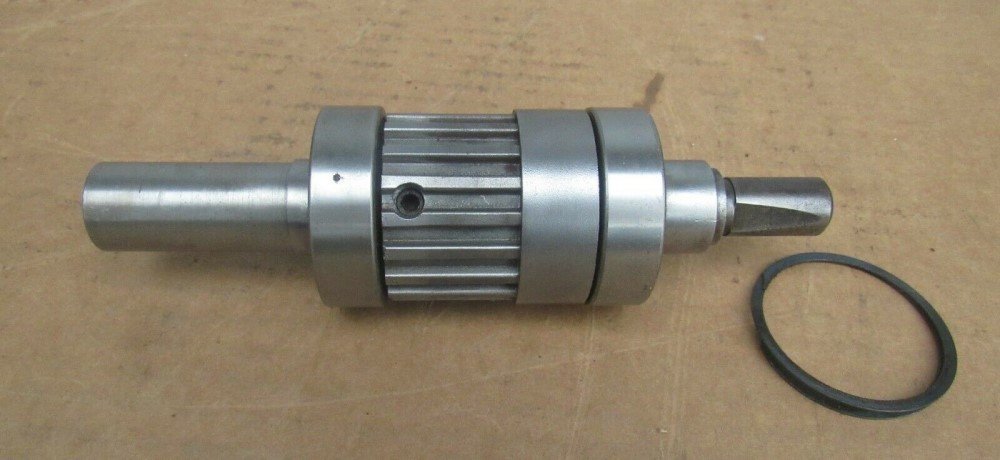

Depending on when it was made the first Mark 5 Greenies did not have a clutch in the Drive Sleeve Assembly. A clutched version soon became available as breaking belts became a problem. To see which one you have the first picture below is the Gilmer Drive Sleeve Assembly without a clutch.
_ .
The set screw on this non-clutched Gilmer Drive Sleeve Assembly is in the teeth as seen above. Because it doesn't have a clutch there is no slippage allowed in case of a jam.

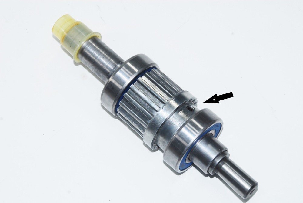

The picture below shows the location of the set screw, indicated by the arrow, on a clutched Drive Sleeve Assembly.
_ .
Even with a clutched version the assembly may no longer slip helping to avoid a belt breaking as designed.
