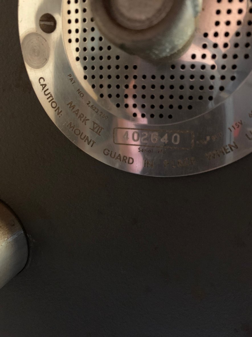

I've had serious difficulty trying to find a resource to determine the age of my Mark VII. Also, is there a list of the accessories that would have come with the machine? I'd really appreciate some assistance.

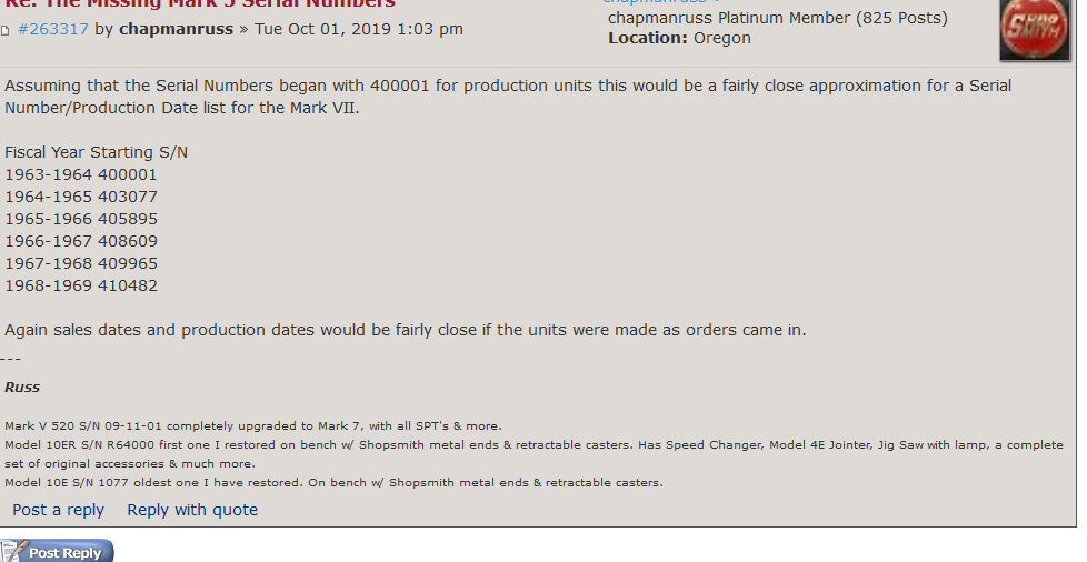

Here is a list of serial numbers and dates.
Hopefully someone will chime in on any accessories different from the MKV. I think most of them are the same as MKV.

Re: How Do I Determine The Age of my Mark VII?
SmithWRX, Welcome to the Shopsmith Forum.
Do keep in mind that the post above of a previous post of mine is an estimate only. To my knowledge, other than the sales history, there have been no other records found.
