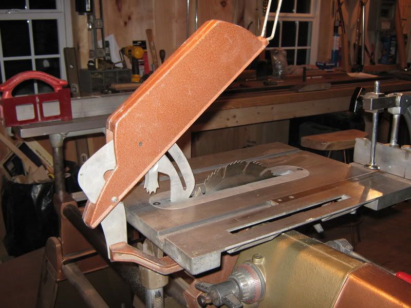

I am interested in a 9" thin kerf blade for my 500 - can anyone offer a recommendation? I have a relatively new SS brand 10" TK blade but I would like a 9" blade that will fit in my vintage blade guards.
I KNOW that the new guards are a great improvement, but I like the old one and am looking for a blade to use with it. Thanks in advance. Alec

Yes Bruce - my Goldie is a 1960 and it has a saw guard that fits only 9" blades. It predates the round dust collection port as the port in the guard is rectangular. The top guard is the aluminum model, equipped with riving knife and anti-kickback pawls. When adjusted properly it works fine. I'll post some pictures later.

Bruce - here are some pictures of my Goldie's saw guard. Alec

Couldn't help but notice the extra 'slot' in the miter guage!;) Got one of those myself(among others).:D One of the joys of the 'extra' slot!:rolleyes:

I suppose that mitre gauge cut is something of a right of passage! :D
