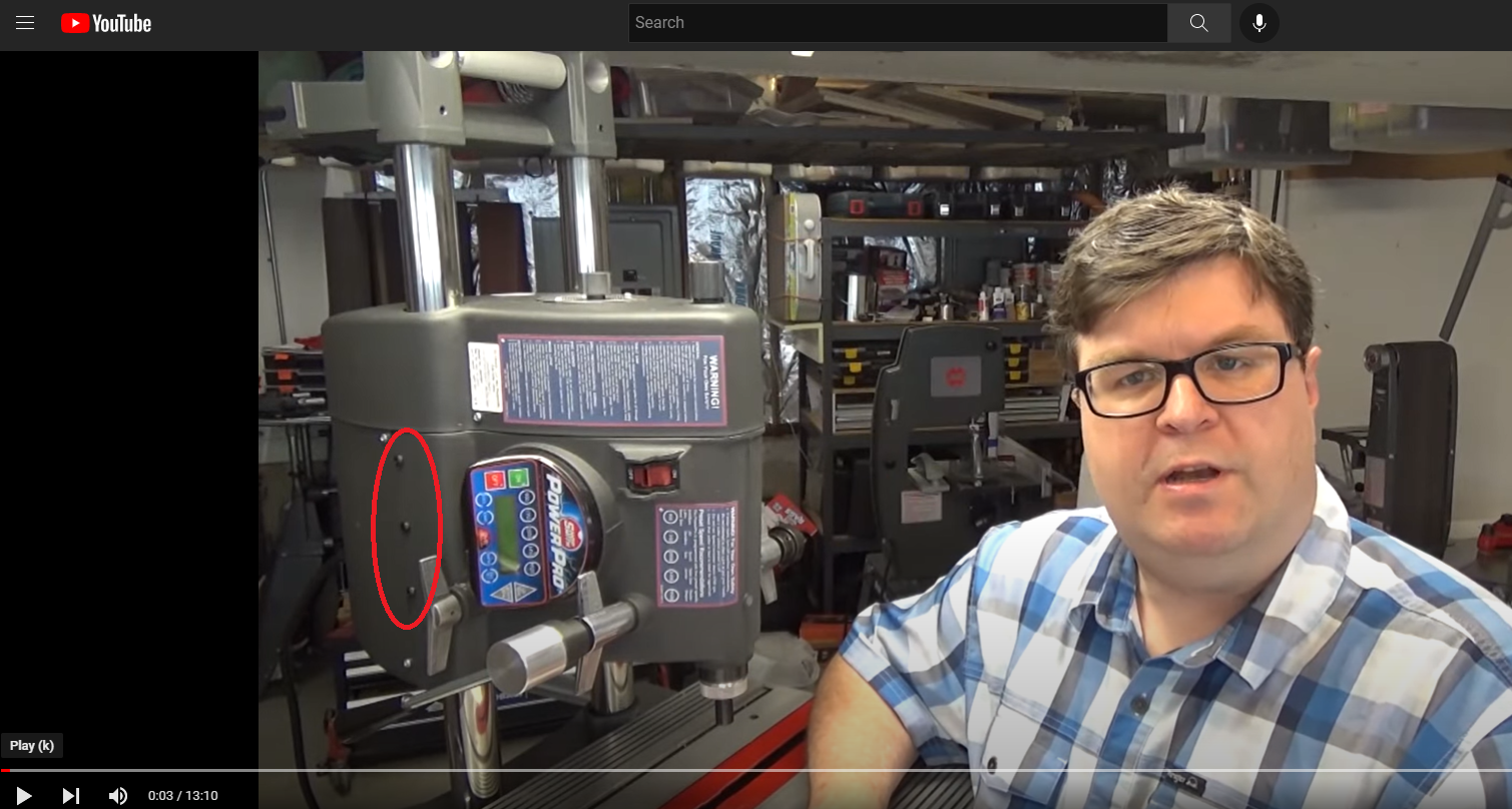

In a recent Woodshop Nerdery video I noticed that Tom's shiny new M7 headstock appears to have some fasteners that my DIY PowerPro does not. A manufacturing change? Possibly a change to how the motor mounts in the headstock?

That is very interesting and approximately where the motor mounts are. The motor mount screws are normally hidden by the belt cover so if those are the only motor mounting screws they would needed to change the casting and motor pan. They could be additional support screws for the motor mount blocks but it looks like they need to be removed to get the motor pan off.

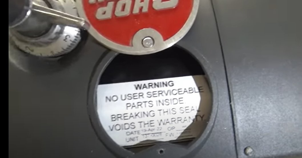

This Woodshop Nerdery video, maybe the same one above, at 8:57 shows a seal over the inspection port on the back side of the headstock. I hadn't heard about that so far, does that mean a new headstock has to be returned to Shopsmith if it has a problem under warranty?
The new fasteners on the sides clearly go through the casting, and could be the motor mounting screws, but I think the mount must have changed for a new position. Not hard to do if it's only the intermediate mounting block. The current service parts diagram for the Mark 7 headstock doesn't show those fasteners.

Is the inspection port completely sealed off now on new PowerPro's??? IF so, that is very disappointing. I would want to install supplemental cooling for positive air displacement in the headstock should I ever purchase a PowerPro. Disappointing if Shopsmith has blocked off this access port now...

edma194 wrote: Thu Jun 23, 2022 4:25 pm This Woodshop Nerdery video, maybe the same one above, at 8:57 shows a seal over the inspection port on the back side of the headstock. I hadn't heard about that so far, does that mean a new headstock has to be returned to Shopsmith if it has a problem under warranty?
Please look at the video again and LISTEN to what he says. It is not a seal on the inspection port. It is a warning label on the computer control box inside the head stock that happens to be visible from the inspection port..

jsburger wrote: Thu Jun 23, 2022 8:28 pm Please look at the video again and LISTEN to what he says. It is not a seal on the inspection port. It is a warning label on the computer control box inside the head stock that happens to be visible from the inspection port..
Well that was kind of dumb. I was looking for shots of those screws and didn't have the sound on. Should have at least turned on sub-titles.

I went back and reviewed his unboxing video. I did not learn why SS replaced Tom's Mark 7. But I found it interesting that his initial machine did not appear to have the screws that are the subject of this thread.
