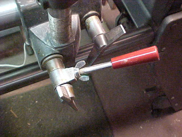

I've noticed that there are quite a few people buying used Shopsmiths, especially the older Mark V versions. I bought mine new about 27 years ago, and always had a few aggravations with it, especially in turning mode, and I like to turn. One was the stick type handles, vibrating loose when I had a big out of balance chunk to start on. Fix: Chase the threads about a half inch farther up the handle and install wing nuts. End of problem.

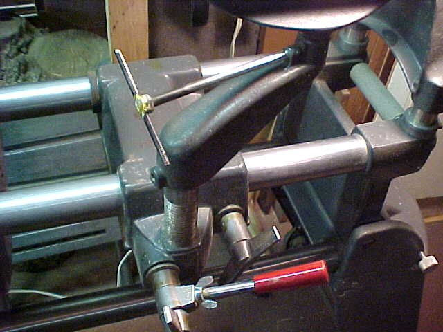

Having to get an allen wrench every time I wanted to adjust the tool rest was a nuisance. Fix: I picked up a six inch bolt (same thread), ground a groove in the head and silver soldered a cross pin to it (T handle).

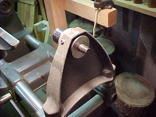

Next was the tailstock center holder, made from soft aluminum. It would creep off position. I installed a second set screw, which helped, but it still was not satisfactory. Fix: I made one out of steel and drilled it dead center, reamed it to a #2 MT, and adjusted the stop collars on the tailstock for height. I check it periodically, but haven't had to reset it for years.

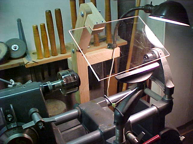

Being 70 now, my eyes aren't what they used to be, and I wanted to use a headband magnifier instead of my face shield. With the lathe tool rest installed, there is an unused hole in the other side of the slide. I had some oak 2"x 2" stock on hand, so I turned a stub on one end to fit that hole and cobbled an adjustable shield with an offset to hold a goose neck light. Both travel with the tool rest, and the shield keeps chips out of my shirt pockets as a bonus.
